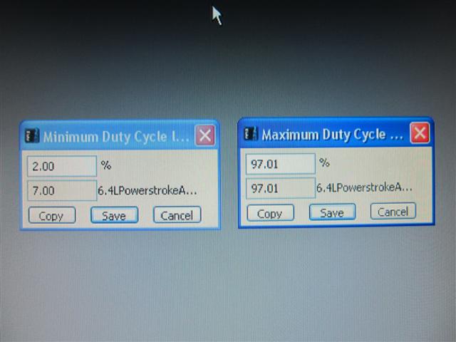

Under the Turbo values heading there are the minimum & maximum duty cycle limit settings. I figured these would limit the actuator from bottoming full stroke at either end. H&S has lowered the minimum limit from 7% to 2%.
d on d makes a very good point, probably a much better idea to set the table values inside these limits for added insurance. I will change my 0.0 % to 3-5% just to be safe.

you could probably peg them out without any issues, it's just old habits die hard... 2-3% should be safe. I would imagine that the 6.4's controller is far stronger/more advanced than the old style solenoid
