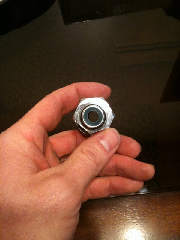

So today I picked all that stuff up. I need to get my mounting bracket holes drilled a smidge wider, and I'm going to get this rig for the drain port drilled out some while I'm at the machine shop. That should help it flow a bit more.

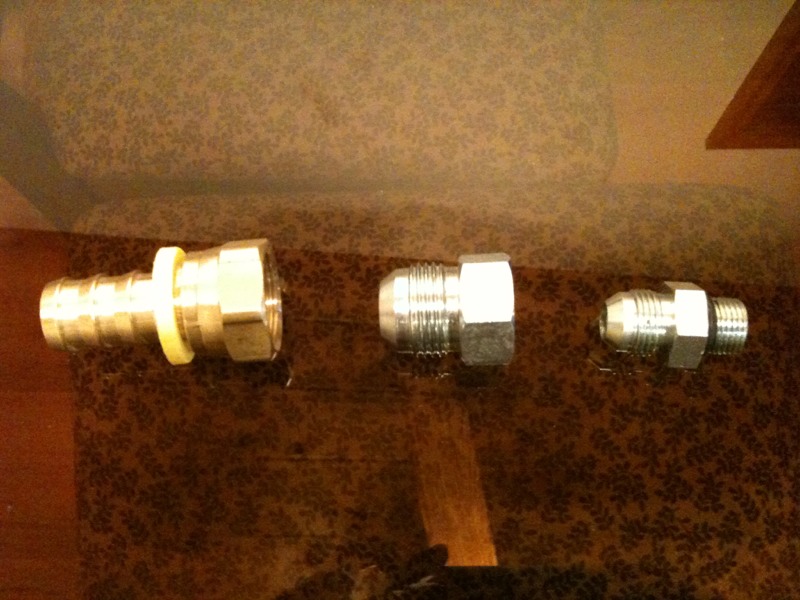

The first picture is the fitting broken down, 3/4 barb to something flared in the middle to M16x1.5. The second pic is through the barb with the whole thing together to show the restriction. The third shows the barb without the other parts, the fourth is the flared in-betweenie, and the fifth is the M16x1.5 side of the other adaptor.
