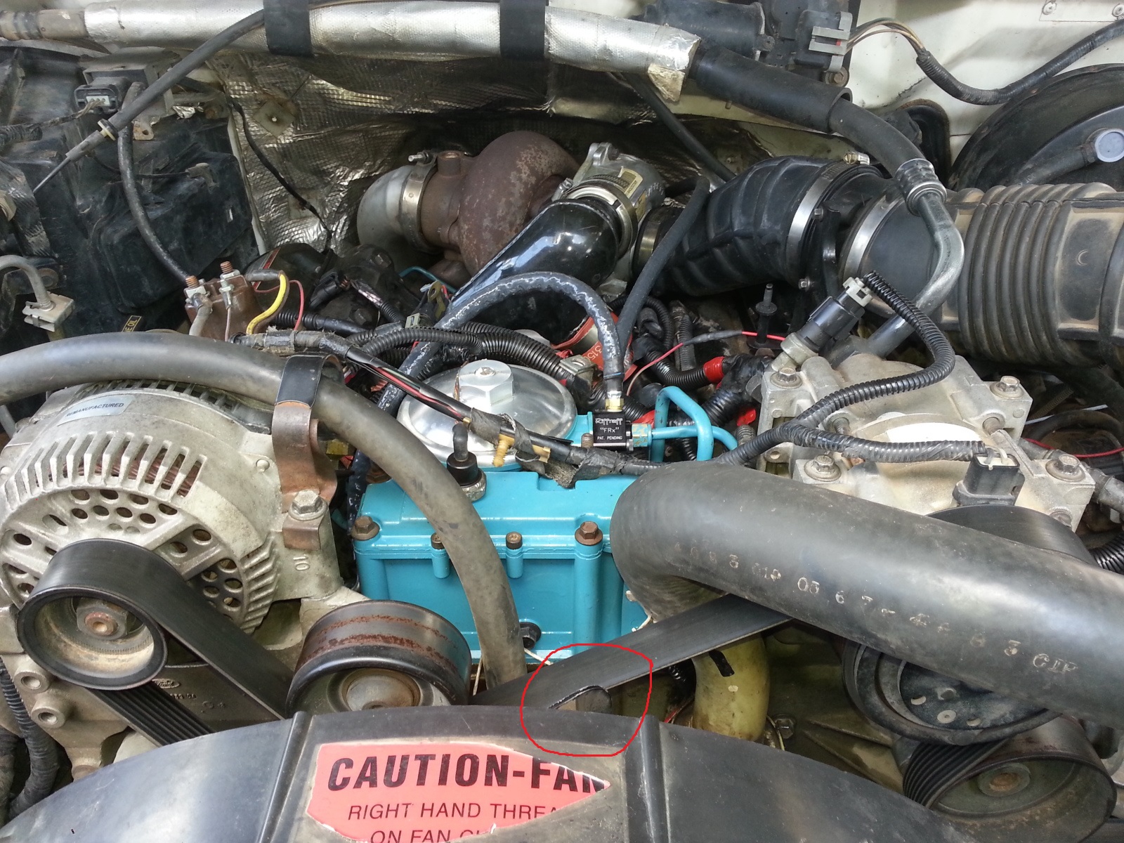

That is a notch of out of the belt. You can see how the lines on the HPOP reservoir carry down.
Got4wd
Jul 13, 2011
165
Looks like the belt is bad, but it's the edge of the fan blade for sure.

I zoomed way in and think you are actually right on it being fan blade.

Well guys, this issue has been intermittent on this truck. I've tried at least 3 different cam sensors, all ford sensors, and none of the sensors showing evidence of cam gear walk... I'm thinking I either have an uvch loose, or got a bad batch of cam sensors/ cam sensor harness issues. I'm thinking I must have moved whatever the problematic wire is while doing my e fuel install, because truck ran perfect before it. Anyone dealt with this before? I've worked on a lot of 7.3`s but never dealt with violent bucking...
