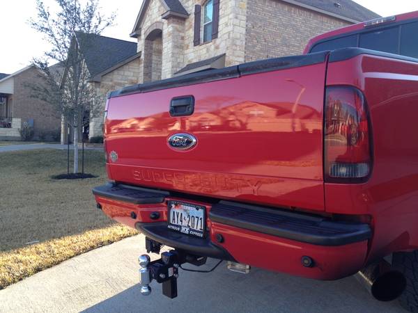

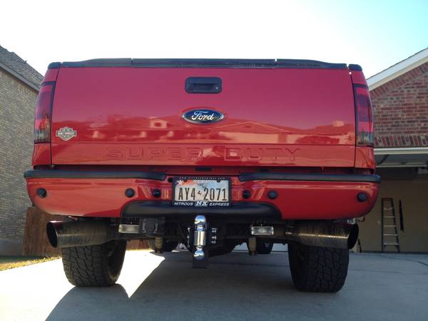

Looks like Jeff is replacing the HPOP. He also called me today and said. "hey did you know that your y pipe was split???? BAD???? No symptoms at all except its been real smokey lately, even more than normal. No sound, no smell nothing. Shes gonna be a new beast. Also got my new 09 tailgate with step and reverse camera painted and installed. It looks great. I'll post pics soon.

thats awesome, your 03 is one of the few older trucks that still looks like it was new yesterday

I never realized how nice your Red truck was, sweet ride. Glad you got it figured out.

did u get the bracket so the tailgate assist works ?
that's the bests part of the new ones IMHO

As always Tim, your truck looks great. Like has been previously said, I've always liked that thing. :D
