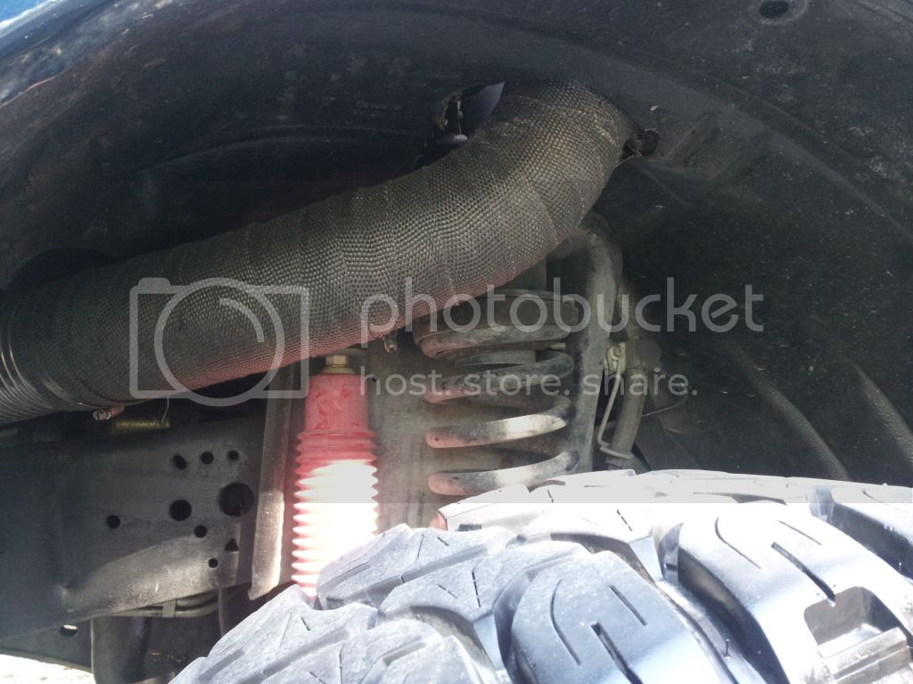

we cut out my inner fender well pretty close to the downpipe for my primary. it's sealed up pretty good and so far nothing has gotten up into the engine bay. i think if you really wanted to keep it clean, this would be the easiest way if you put a little more work into it...
Lol that's about how mine came out the first time but I cut the fender a little more hahaha.
Gotta remember though my trucks lowered so I can't have dp sticking out at all

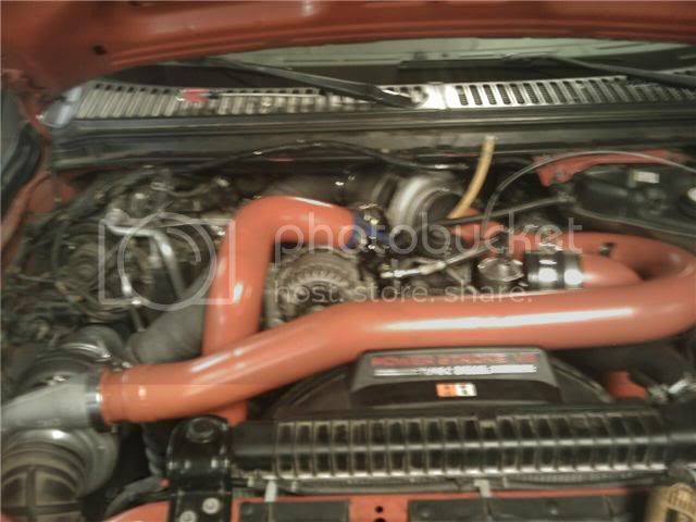

Does anyone have pics of both of them stuffed in the valley, besides the ones that II and Elite have assembled? I was looking at it the other day, and I was thinking you could mount the LP in the valley just like the stock trubo and the HP over the passenger side valve cover.

delete the fuel bowl, relocate the oil filter, and ATM them things in the valley.
