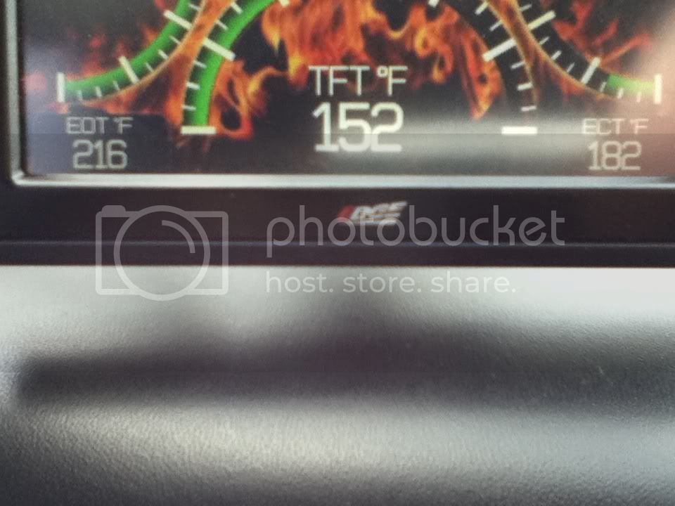

Fox'sFord, thank you for digging this information up. I was sure that I had read in the past that the VT 365 or the "Powerstroke in reliable gear "was serviced with ELC. I have ELC in mine and really love the peace of mind. I have not had any Cooler problems, though I am deleted I still rarely see any EOT and ECT differences above 8 Deg delta with any load placed on the motor. I really think that there are too many people that carry their personal opinion as gospel. Love the Army so far, looking forward to a place where the PSD and Scorpion fans can gather and share info without the impedance of stupidity. :poke:

My oil cooler is plugged at 82k miles so milage I would say is not as important as age since its 7 years old with the motorcraft gold.As soon as I get the cooler changed its getting elc and a filter. I have a slight difference in temps lol.
