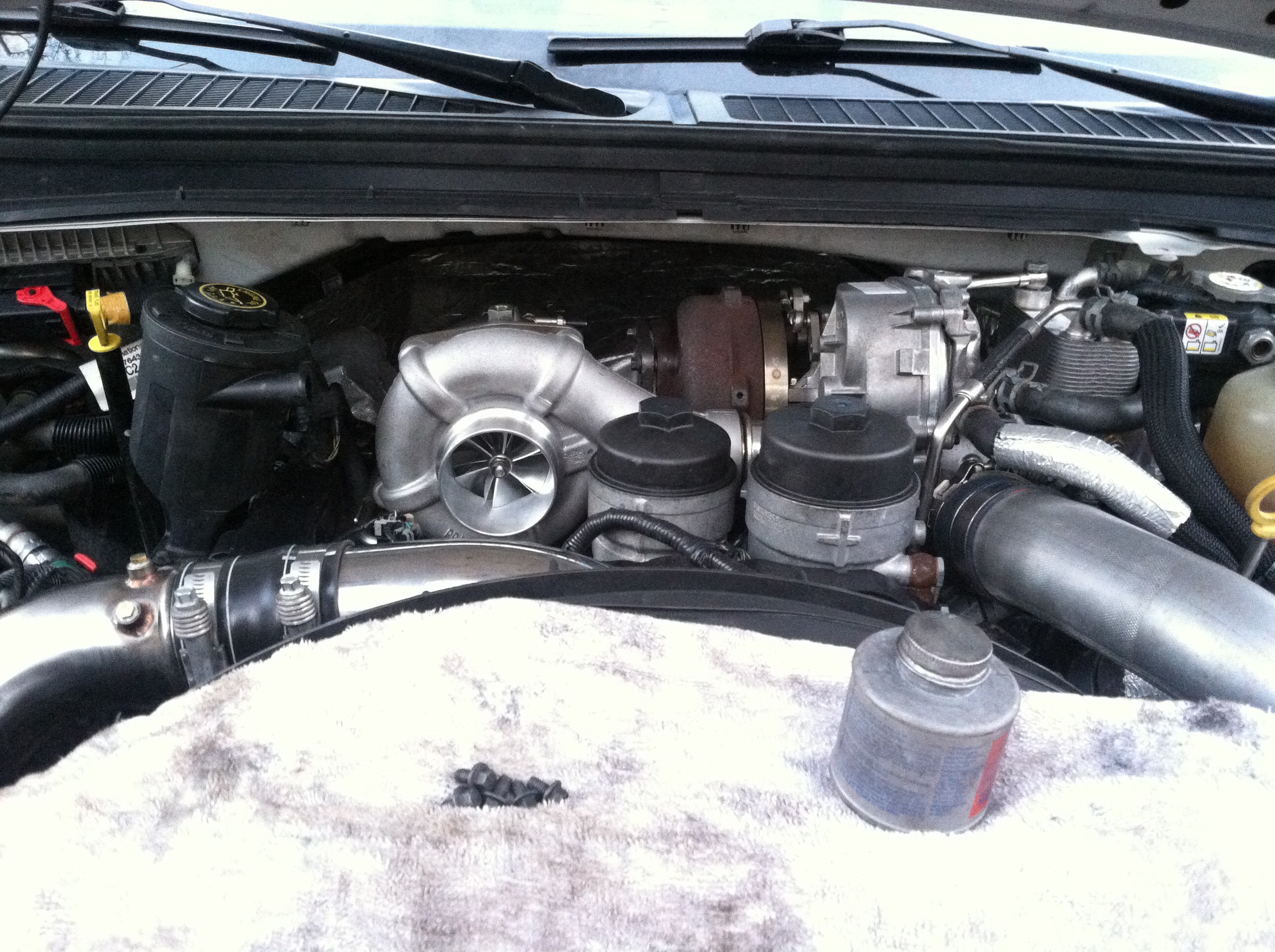

6speedsd
Jun 9, 2011
3,468
Olive Branch, MS
Pulled the turbo and gave it a much needed cleaning.
Fixed an oil leak where the CCV elbow goes into the box.
Had a coolant leak for a while now at the return port on the tank where it comes from the intake manifold. Tried different clamps, new hose...never could get it to seal. Got to looking for a crack while I had the tank off, only to find out someone had stuffed that port full of RTV for whatever reason. Got it all cleaned out so that should fix the leak.
