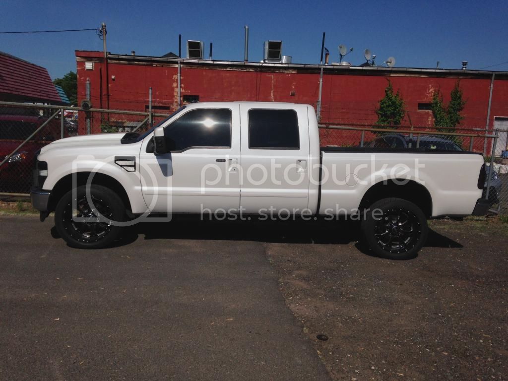

1/4" gap, so pretty much, still rides better then it did with the 6200lb coil springs it had in it. I would imagine once the springs settle it will be on the bump stops full time...i don't see how guys are cutting a coil off 4400lb springs. Even if i trimmed the bump stops in half it would still be pretty close. Probably just leave it like this for the summer/fall and go back to stock height for winter.

I figured they would be close. But dang, that could make for a harsh ride couldn't it? I wonder if you could get a smaller bump stop.

I've been driving it around seems better then before and i'm 99% positive it is bottoming out on the bump every bump i hit, still feels less harsh then with the 6200lb springs it came with which were probably part of a plow prep package.
