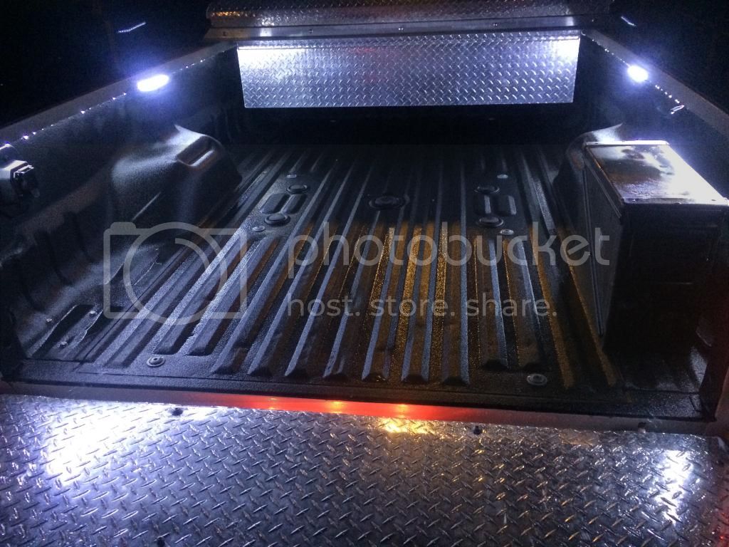

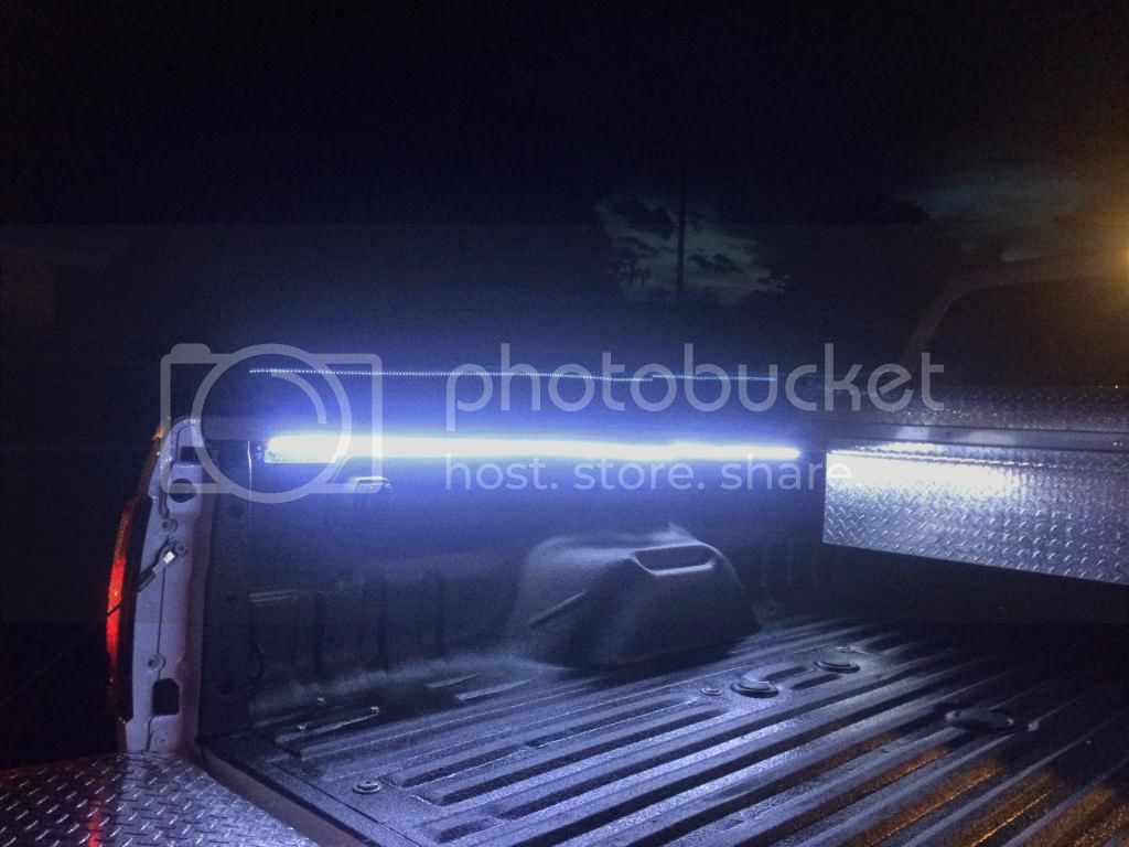

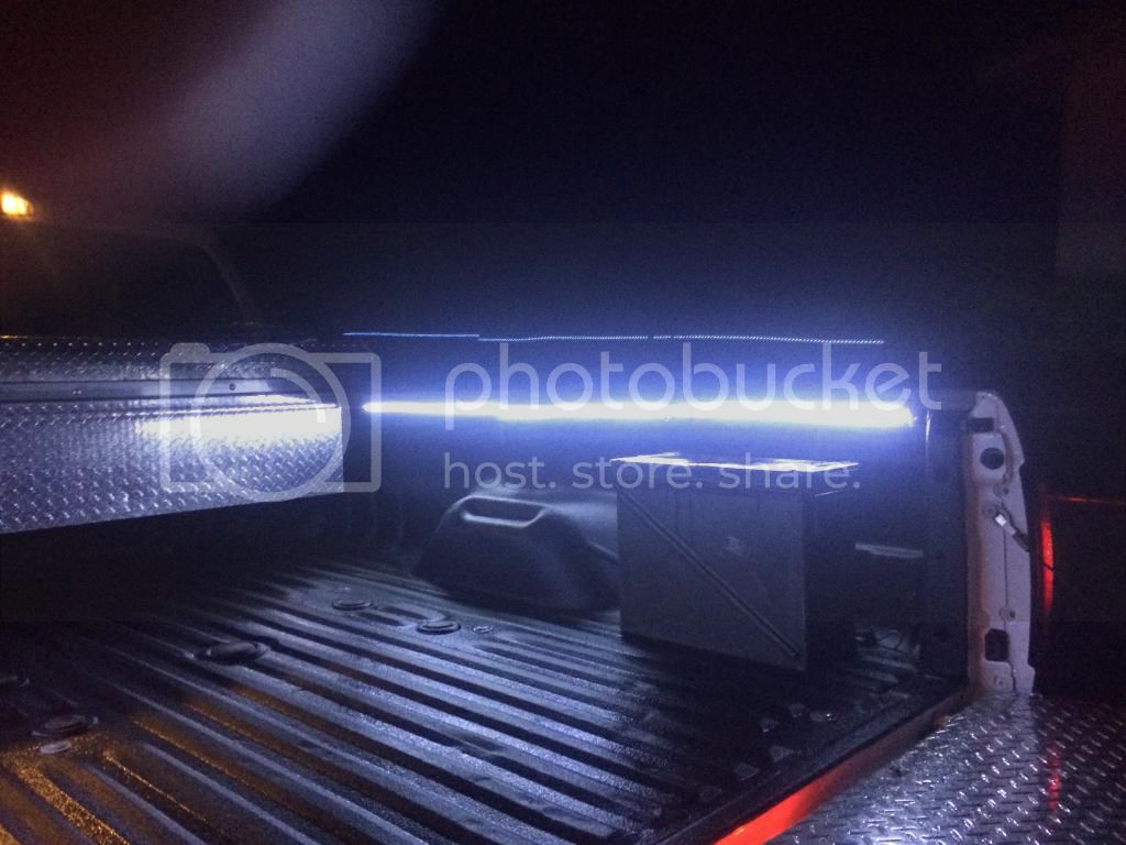

Took just a couple photos today.

Cut to length on the lines and you can re solder wires to continue using the rest. Link them together or whatever. They're cool. I use them a lot. Should be putting red on my buddies runningboards shortly.
Posted while doing something dumb.
sagebel
May 19, 2011
1,111
5
East Chatham, NY
Seriously! $12. Can you just cut the strip to length? How'd they wire up?
The roll I bought has wire leads at each end. I only ran the strip to the toolbox on each side and had about 4' left that I'll use some where after I solder new leads on. The adhesive would not stick to the bedliner very well so I used some superglue and the some clear silicon caulk on edges.
