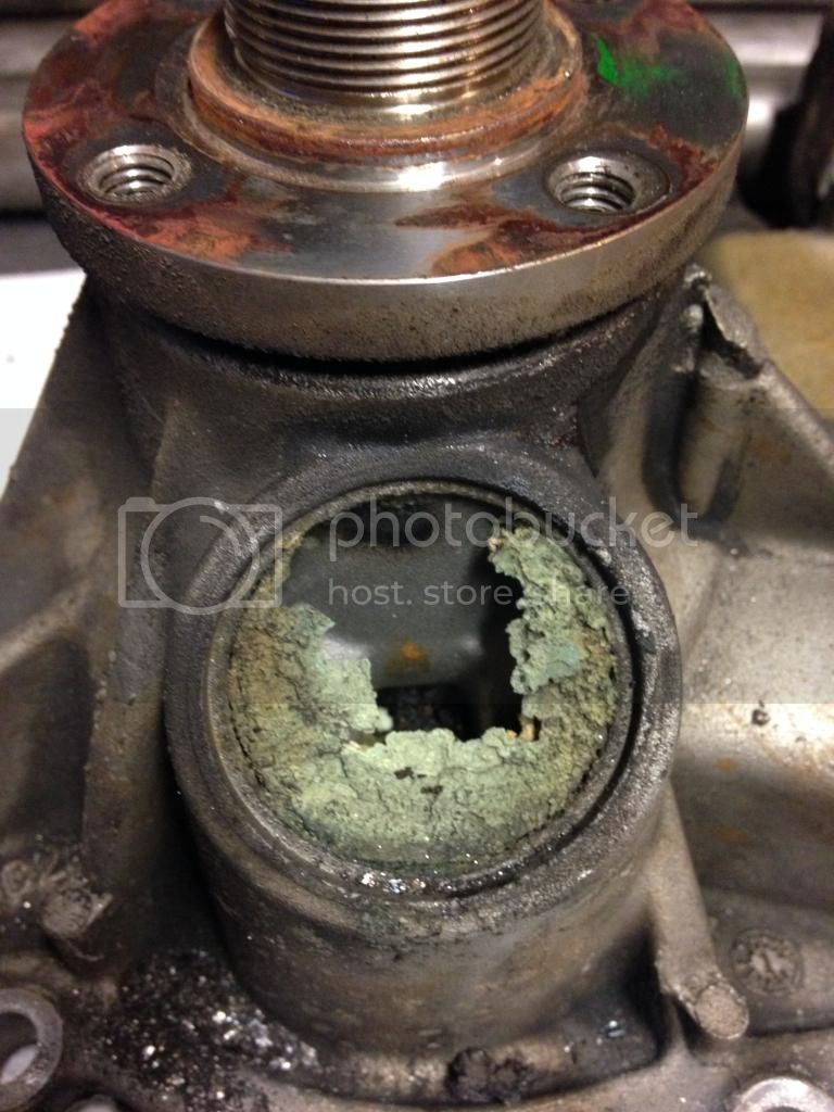

Had it towed back to my house so I could replace the water pump that went out. The plug for the weep hole ended up wedged in one of the pulleys. Bearing behind the pulley is toast with metal shavings everywhere.
A little bit nasty
Going to do a flush and get it all cleaned out.
On a side note for anyone else doing a waterpump on a 2002 7.3L; the neck for the lower radiator hose is different on the 2002 than the previous years....so you actually need to get a hose from a 99-01 truck when you get the water pump. The diameter is larger, so you can't simply cut the old one and slip it on.
