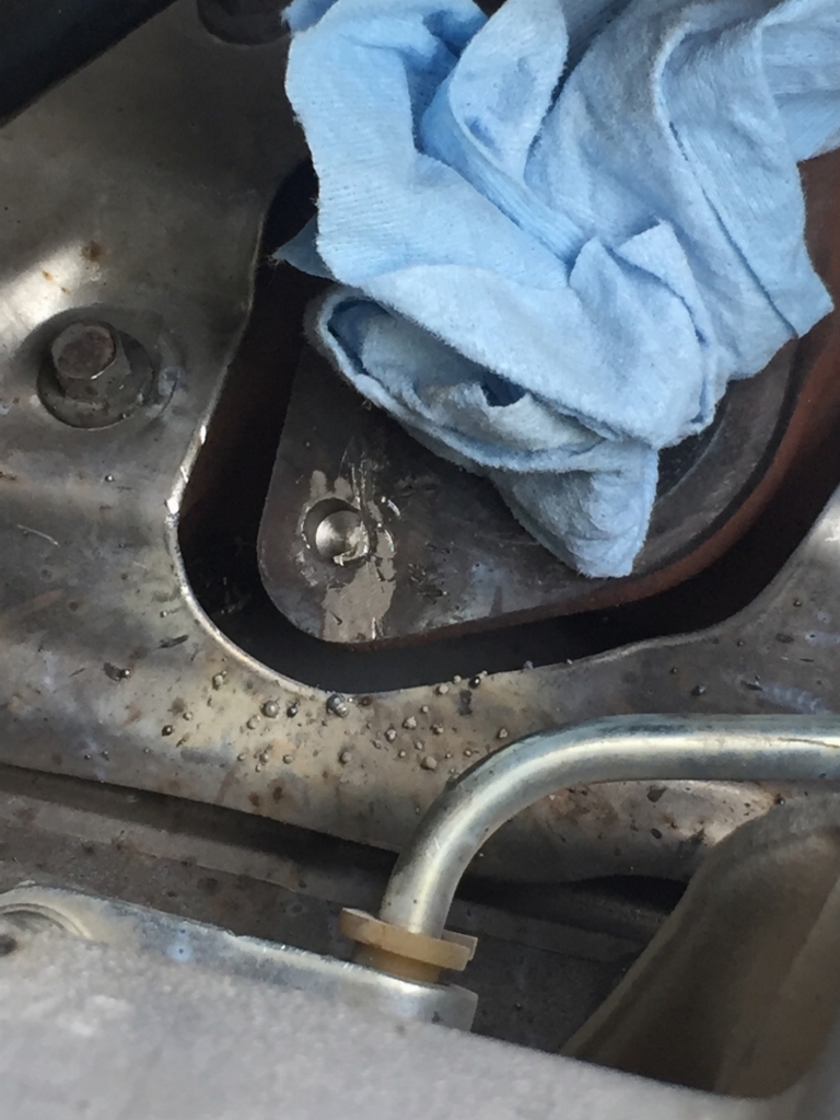

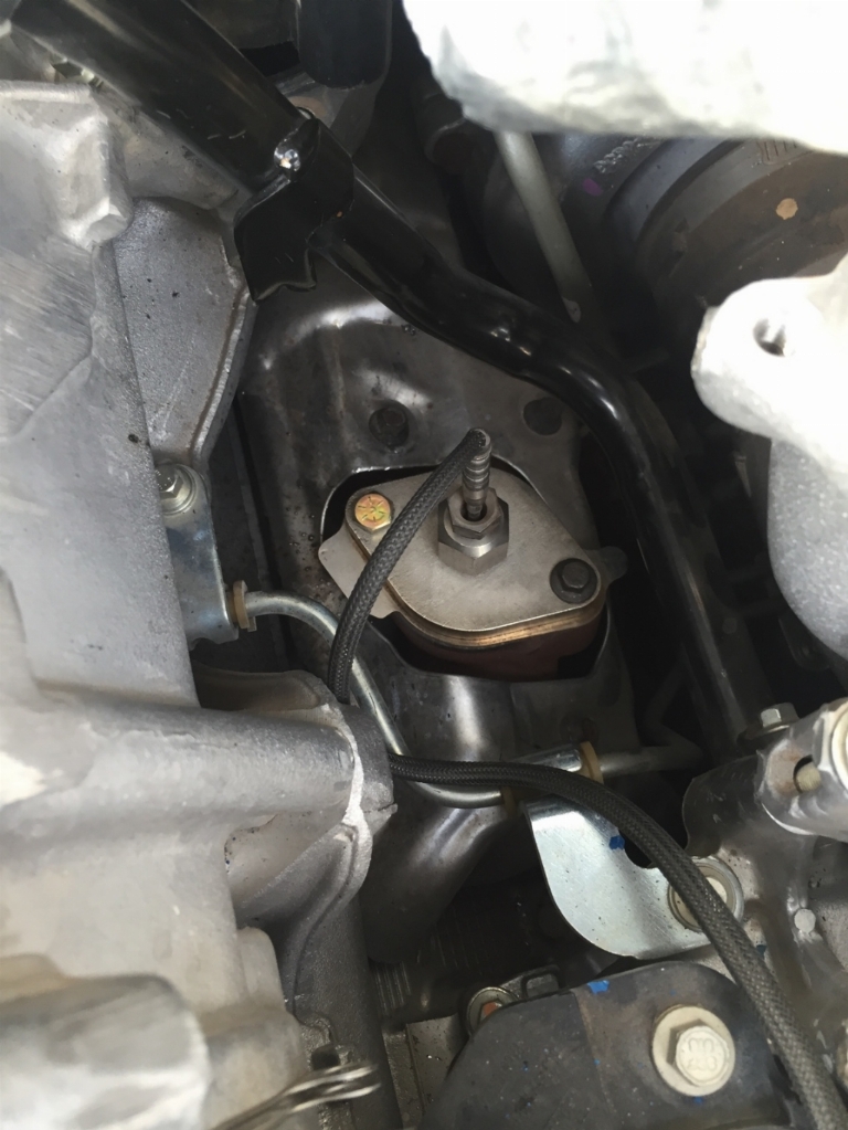

Damn bolt broke off in the manifold. Had to drill and tap it. Tried welding a nut to the 3/8" stud that was still there but it wouldn't budget.
