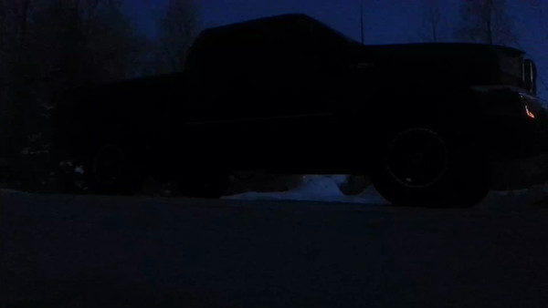

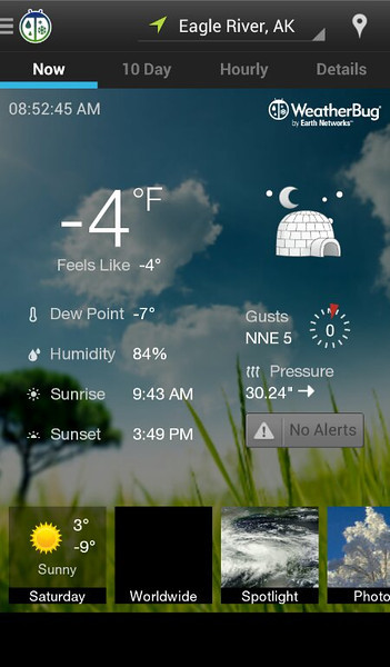

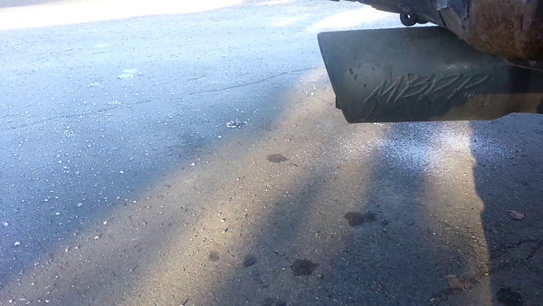

I've started at -35 with Unlimited 200% nozzled injs, and 907Dave even colder with 200% and 400%. You've got something mechanical going on (injectors, GP system, or weak HPOP)
Here's from a couple days after Thanksgiving. Not super cold, but you can see it starts and idles with very good manners. :fordoval:
http://powerstrokearmy.com/forums/showpost.php?p=847530&postcount=67
Gearhead Hydra tuning "All Out" tune
Unlimited 400cc/200% injs
18F air temp
12F oil temp
overnight, no plug, not driven in 5 days, truck has been driven 17 miles since HG replacement, probably still have some air in the HPO sys.

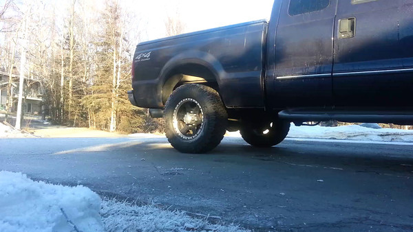

After 5 minutes of idleing (Gearhead "Whisper" tune)
Gearheads Hydra tuning with the new 4 line is the best my truck has idled...ever. I'm sure other tuners have idle figured out too, just posting my experience. The reason for the engine compartment shot, is to show no "shake, rattle, and roll" like I've had before....he'll probably say it's the same tables, and he didn't change a thing now :) ....but I'm just sayin'
Hope this helps. I think the right answer is Unlimited Diesel Injectors, Gearhead tuning, and Swamps HVHF IDM.
