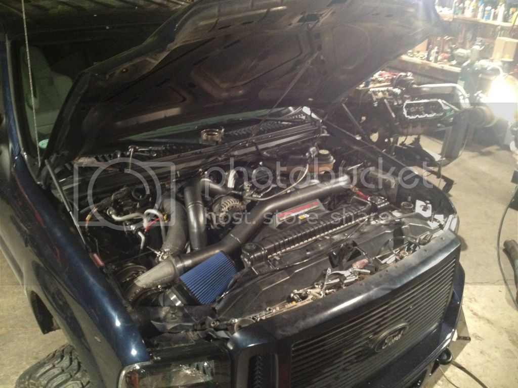

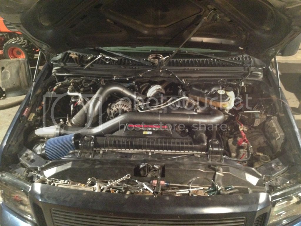

Looks Great!
Matt said Lance wears his boxers backwards for kicks so you can bet he doesn't lit the tires off in the first drive lol
