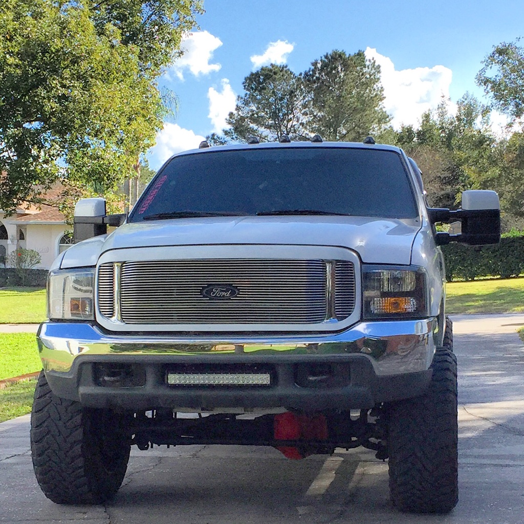

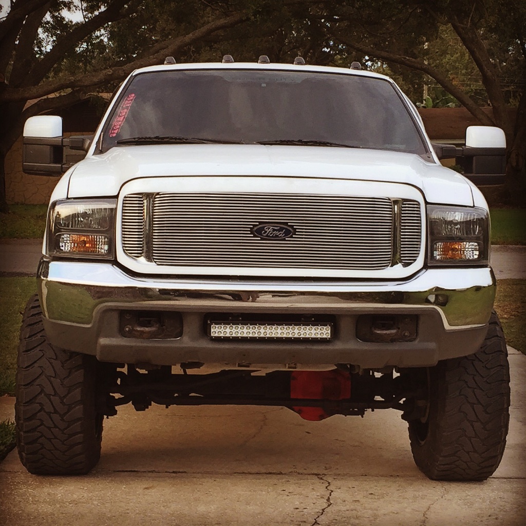

The majority of the rubbing was on the bumper and fender liner. At full lock the tire would barely make contact with the spring. They were toyo M/Ts. Regardless unless you trim with 4 inches or lift it to 5-6 inches it's going to rub like hell.

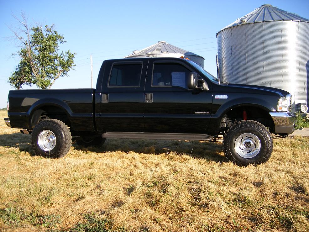

I'm not telling anyone how their truck should or did drive. I'm just saying with the right wheels, a 12.5" wide tire should not rub the springs. My 39.5" tires did rub the leaf springs with the same 12" wide wheels, but the tires were 18" wide, IIRC.
My 35" by 12.5" Super Swamper SSR's did not rub the leaf springs anywhere, and they were pretty aggressive tires.
That is a 3.5 inch hanger lift on stock V-code springs, BTW. 5" rear block. Had to trim the front bumper, and pull back the liners, but did not rub the springs at full lock.

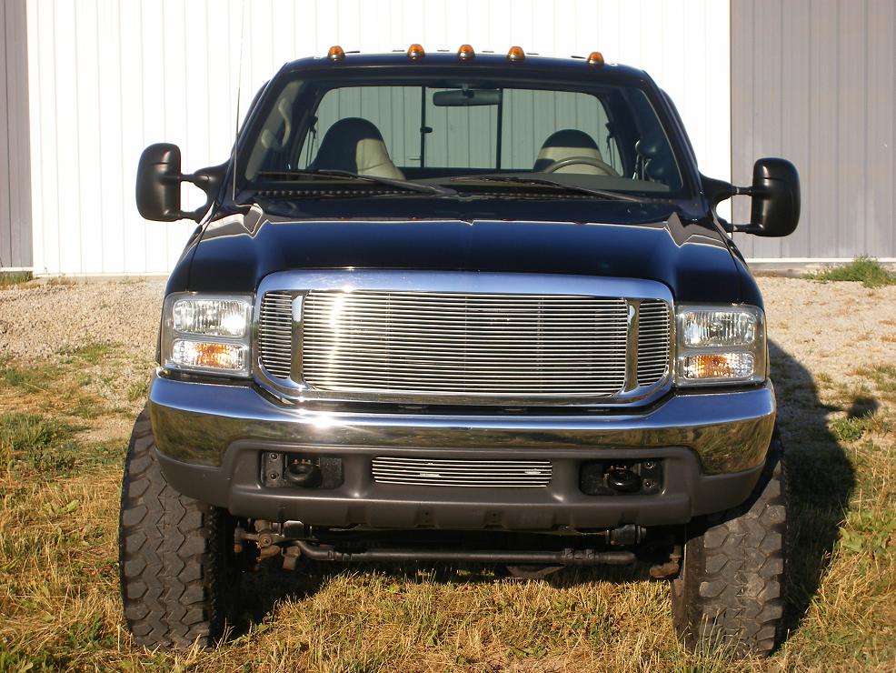

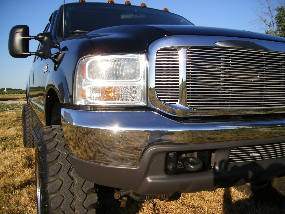

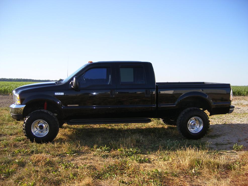

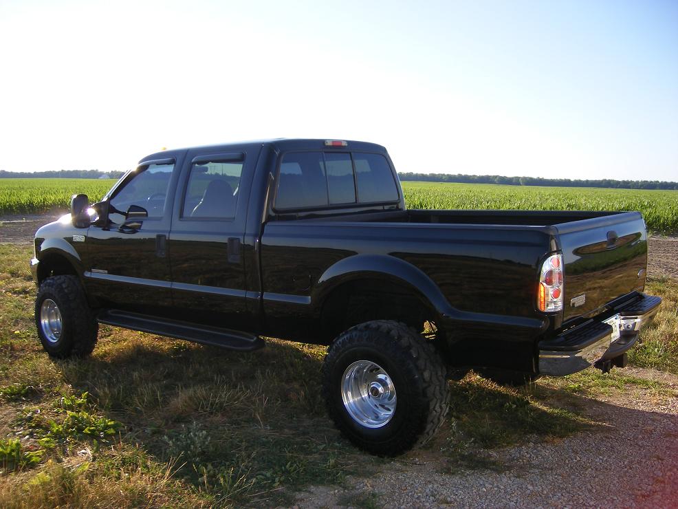

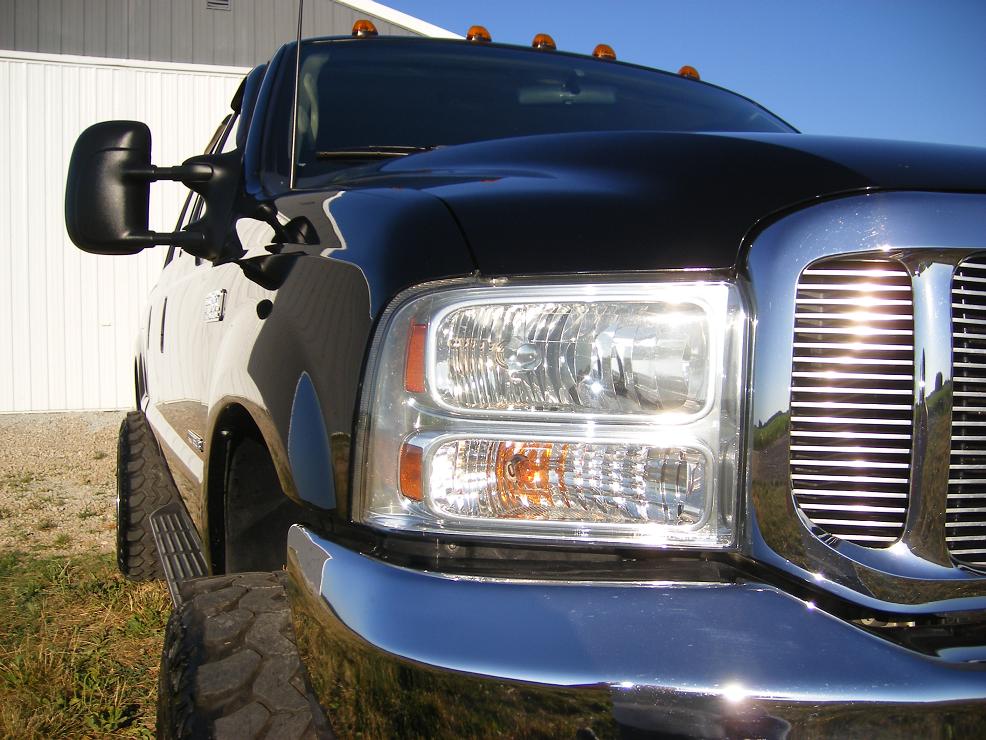

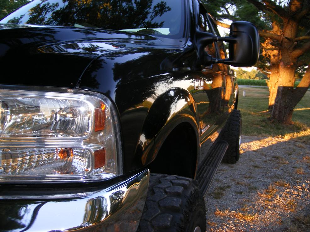

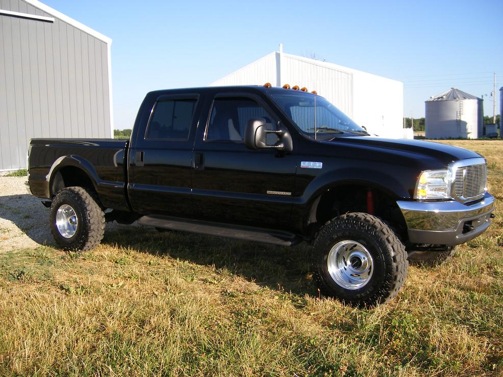

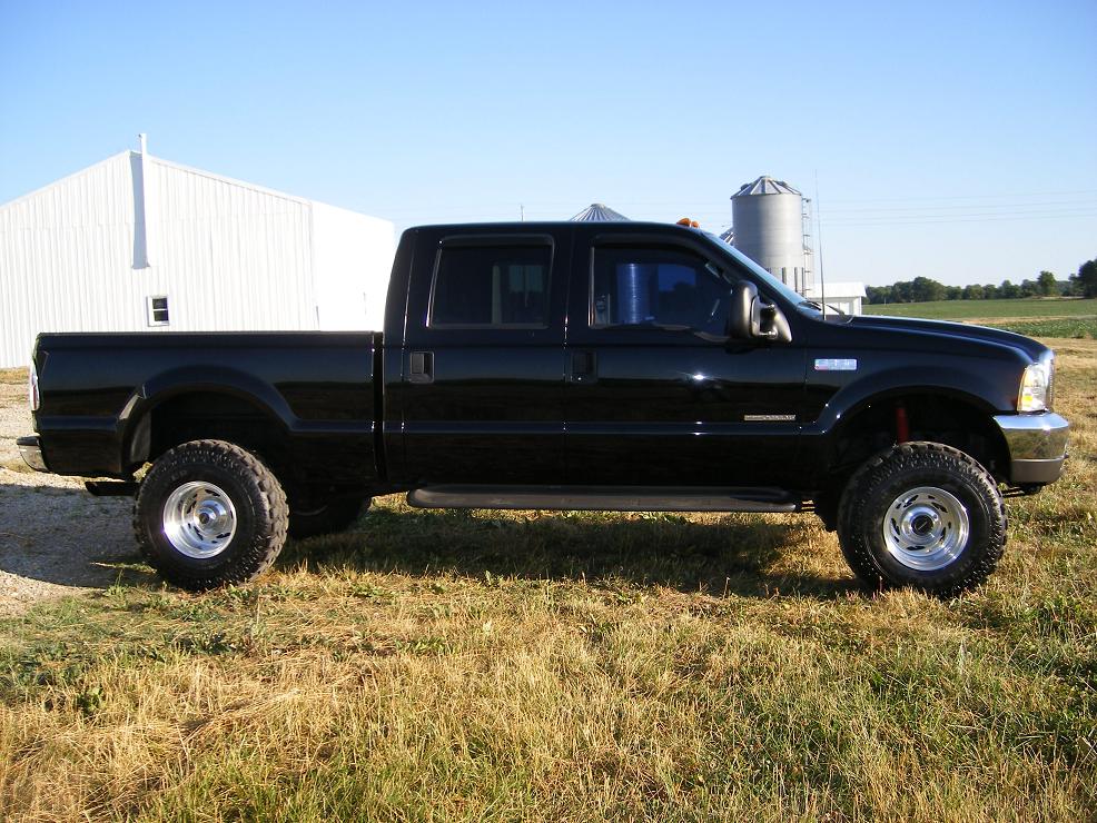

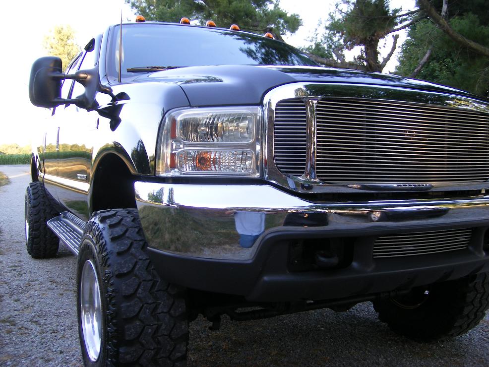

That thing looks good man! The tires stick out perfectly. I'm also a sucker for black haha.
jngreen
1,083
IN
Get some wheels then. I wouldn't be afraid of 12" wide wheels. If for some reason they rub the leaf springs, then you could always run spacers. You could always adjust your suspension some to get a little extra height if needed. You could run your 4" lift, then add a mini spring pack to get an extra inch or more if you needed it. I think a true 4.5 to 5" of lift would be perfect for 35" tires on 12" wide wheels.
