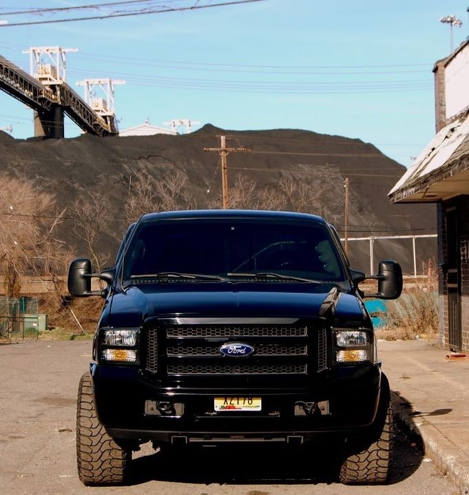

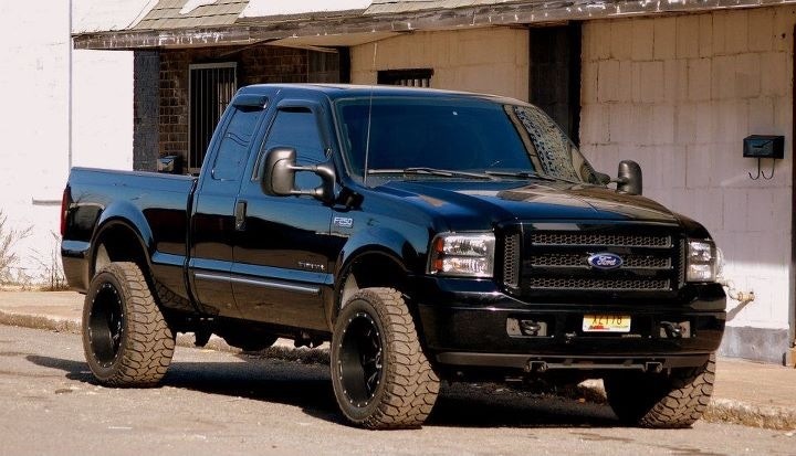

20x12 fuel throttles. 325/50/20 Mickey Thompson atz.
2000 f250 with 07 front end. Completely stock suspension.
Good bit of rubbing left front inner fender liner. Cut about 5-6 inches off to ensure no rubbing. Right fender liner almost never rubs except on uneven ground and at full lock.
I should add that the tires stick out 2-3 inches past the fenders.
View attachment 4742View attachment 4743
Damn that looks so sick!

Yeah, most of the time I be hating on trucks with tires sticking way out, but that one is done up just right.
