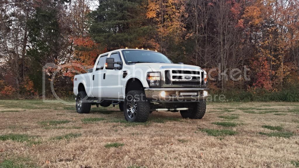

Well I just ordered a 4" BDS with fox shocks and 20x9 0mm offset Gear alloy big blocks with 35x12.50x20 Toyo AT2's. Looking at pics now has me concerned the wheels aren't going to stick out enough. I had 20x9 0 offsets on my 6.4 and they looked perfect to me so I hope these will too. Here is a pic of my old 6.4

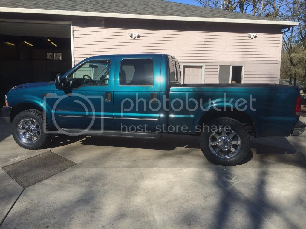

A couple of pics with the polished 20x8s, 2" spacers and 295 60 Procomp MT2. This tire is just over 34" and is about as tight as you can get with stock height. At full lock to left, there is a slight contact with inner liner at bottom. May try to pull it back further.
