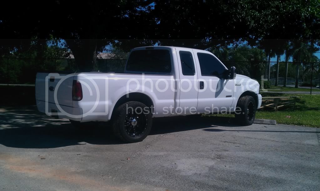

2wd f250 with a 2 inch level( really only Got about 1.5")
20x10 xd diesel wheels 4.5 backspace
305/50r20 cooper tires (32x11)
No rubbing whatsoever.
I want my 4x4 to sit like that!

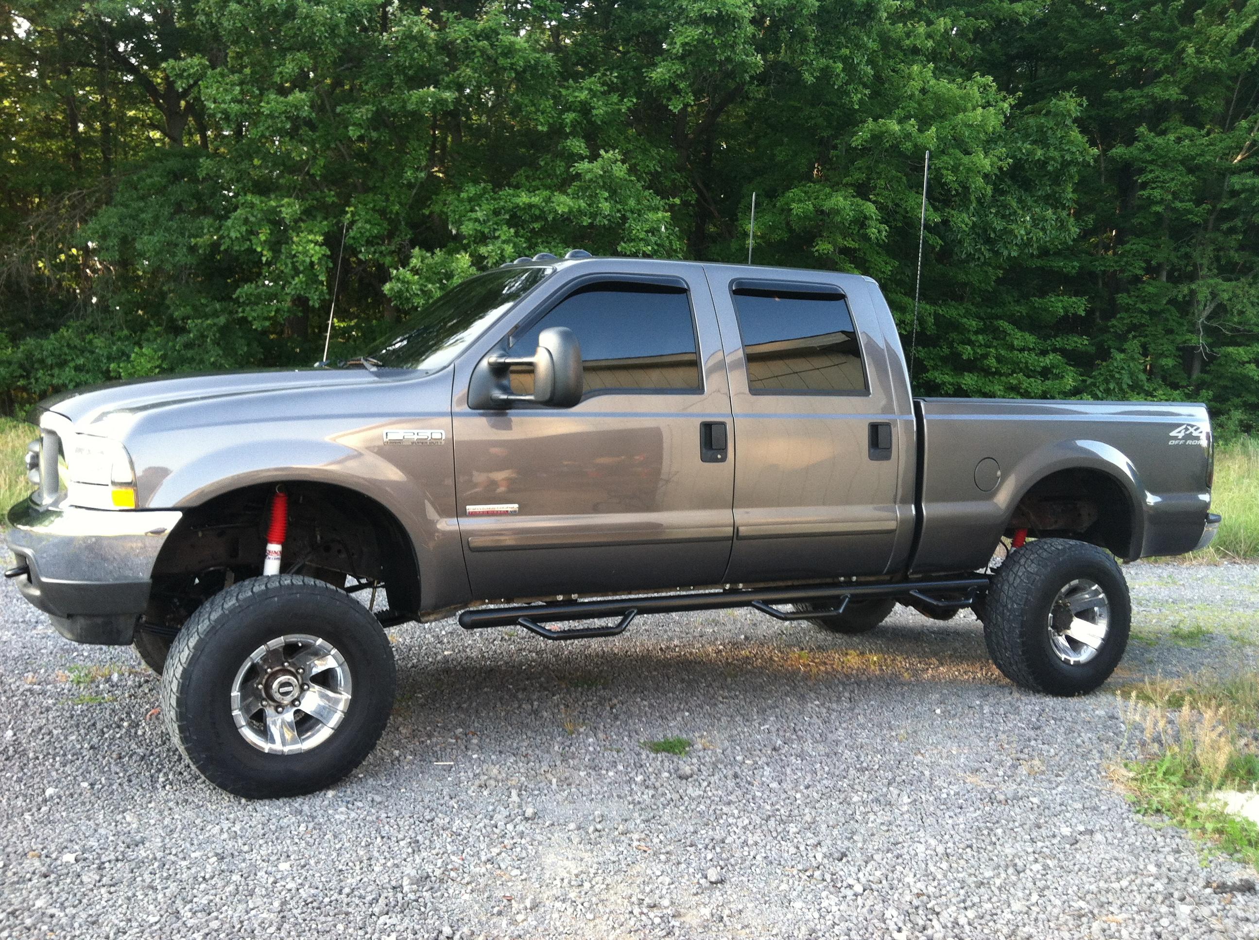

i started reading this thread and just had to join this forum. its awesome and such amazing trucks. And some amazing information that im curious to obtain from anyone. i got an 02 f250 with a 6" spring lift and wanna run the biggest and widest wheel setup possible, i love the wide tall stance it looks so bad*$$.
this is my truck as it sits now.

Widest and tallest for 6" lift is probably a 22x14 and a 37x15.50 or 13.50 tire
TyCorr
Jun 23, 2011
15,461
I did 40x15.5 on 16x12s on a 6" lift.
The 37 is probably "ideal". I love my 35s though. If I wanted something.wider Id get a 36x15.5r20 maybe on a 14" wheel. 37s are the point where the tires feel like a.huuuge drag. Cuz they are.

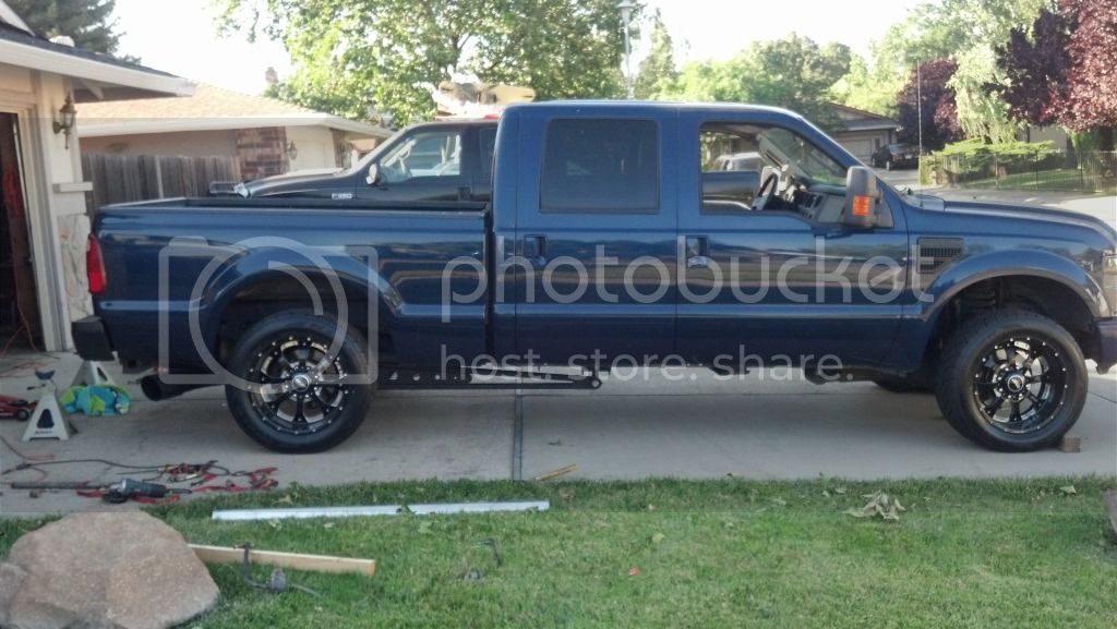

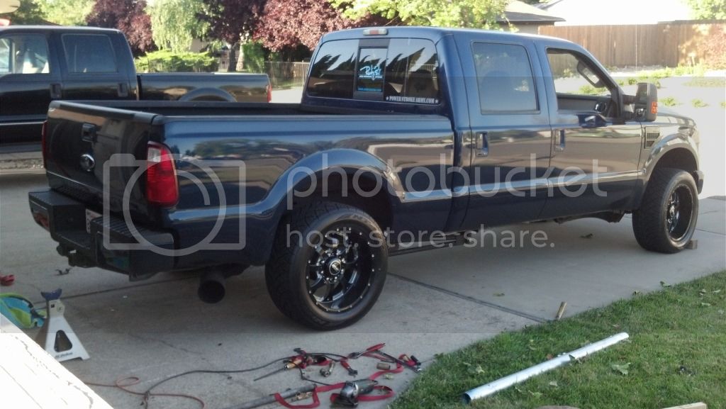

2.5" spacer with 1"tei spacer 7" block. 22x12.25 alcoa super singles -50 offset 37x13.50x22 Toyo m/t's

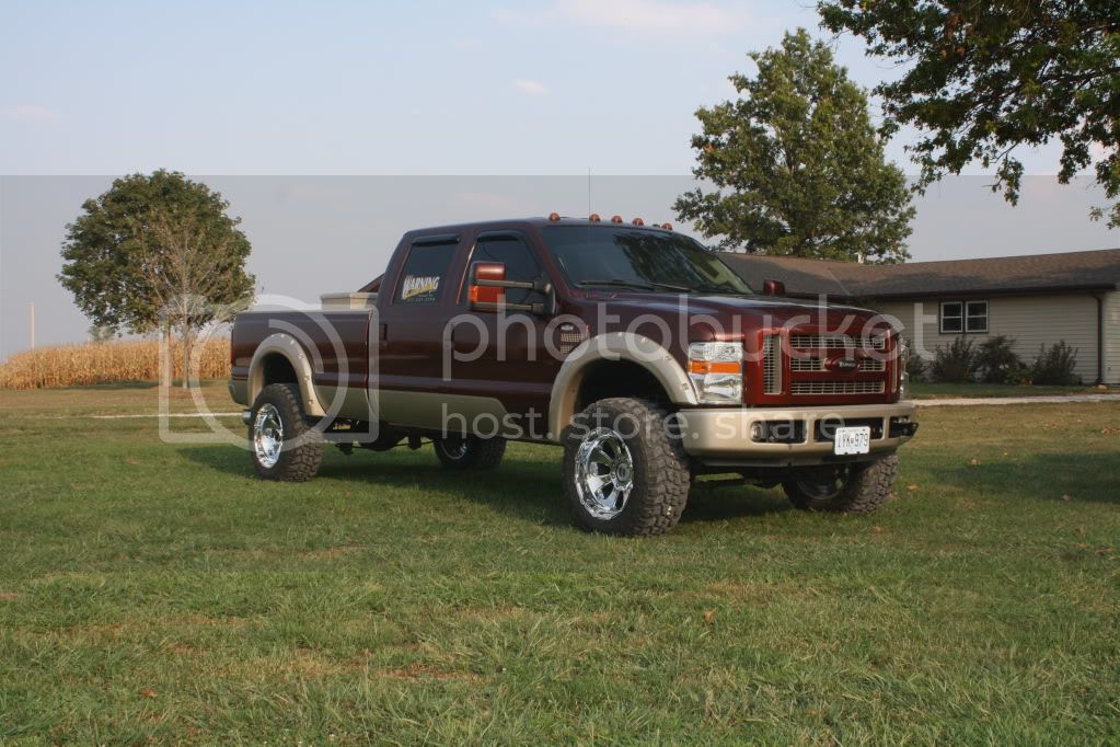

2.5" leveling kit. Stock rear 20x12 xd armors 35x12.50x20 federal m/t's
