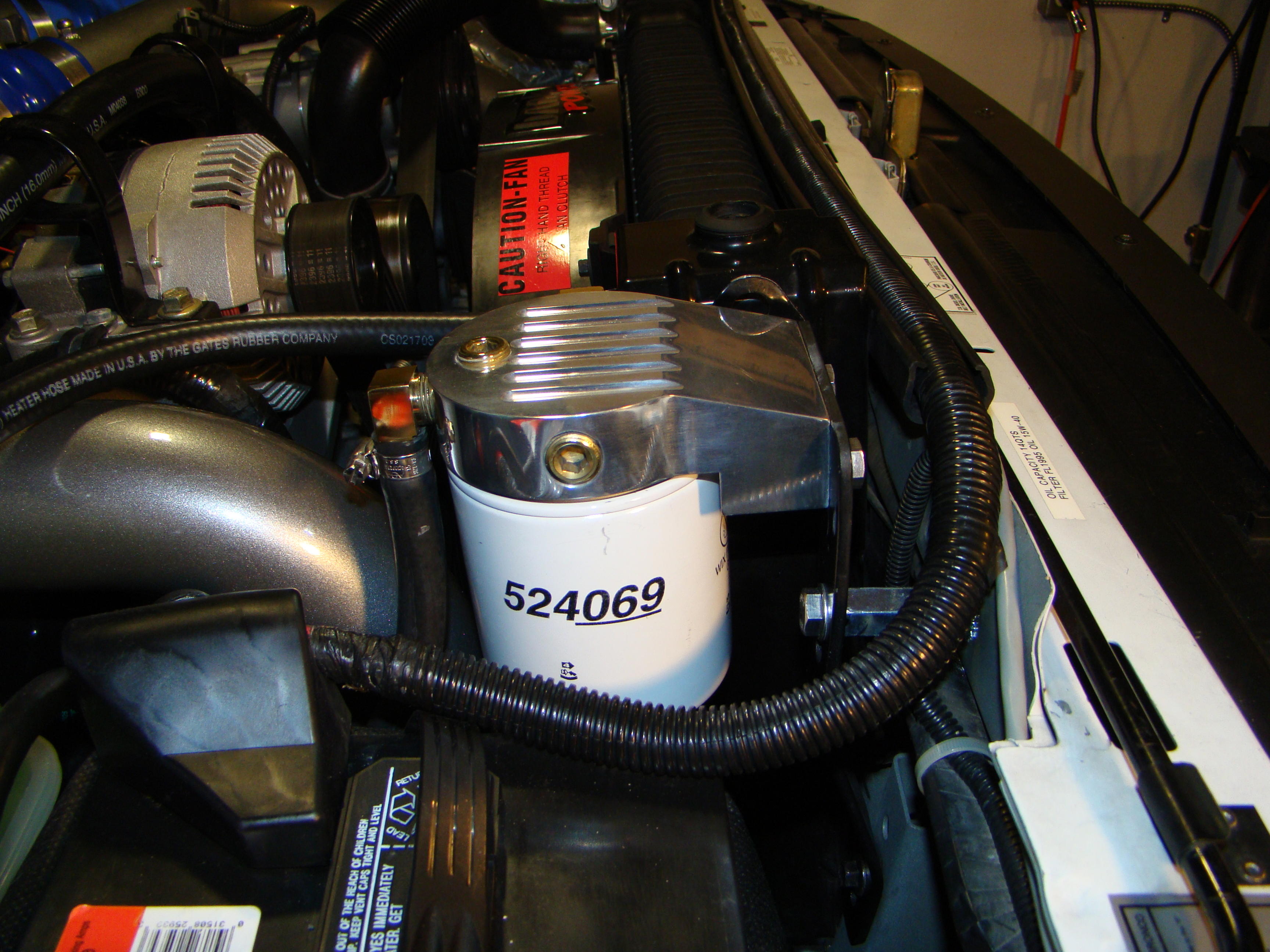

I will try to track down some of those pictures. Webshots got me again.
Tom S
3,365
Found one shot of mine.
soldier_twiggy
Sep 15, 2013
43
Coolant and trans filter on frame below front passenger seat. I ordered an extra 10 feet of hose and ran it down the passenger frame rail.
