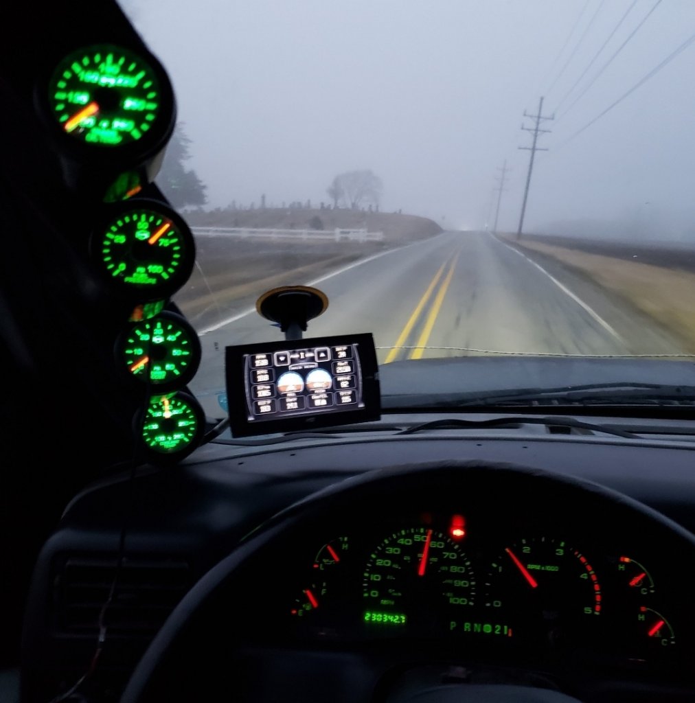

water temp because 7.3s dont have a pid for it, fuel pressure is an absolute must, boost you can pull off the monitor, as well as Pyro.
I have no setup for Pyro yet but I do have a steering column pod that I just have to mount.
Not a fan of oil pressure gauge, it's a huei so if you don't have oil psi you're not running for very long and the dummy gauge on dash actually will tell ya if you don't have low side.

I'll have to grab a less blurry photo but that's trans, fuel, boost, water and with a edge2 I believe

I’d probably throw boost in there, as the factory will only read so high, and not sure if the one does it too, but the super duty’s will go into full retard mode after seeing an overboost, and your edge reads like 6psi max or something.
