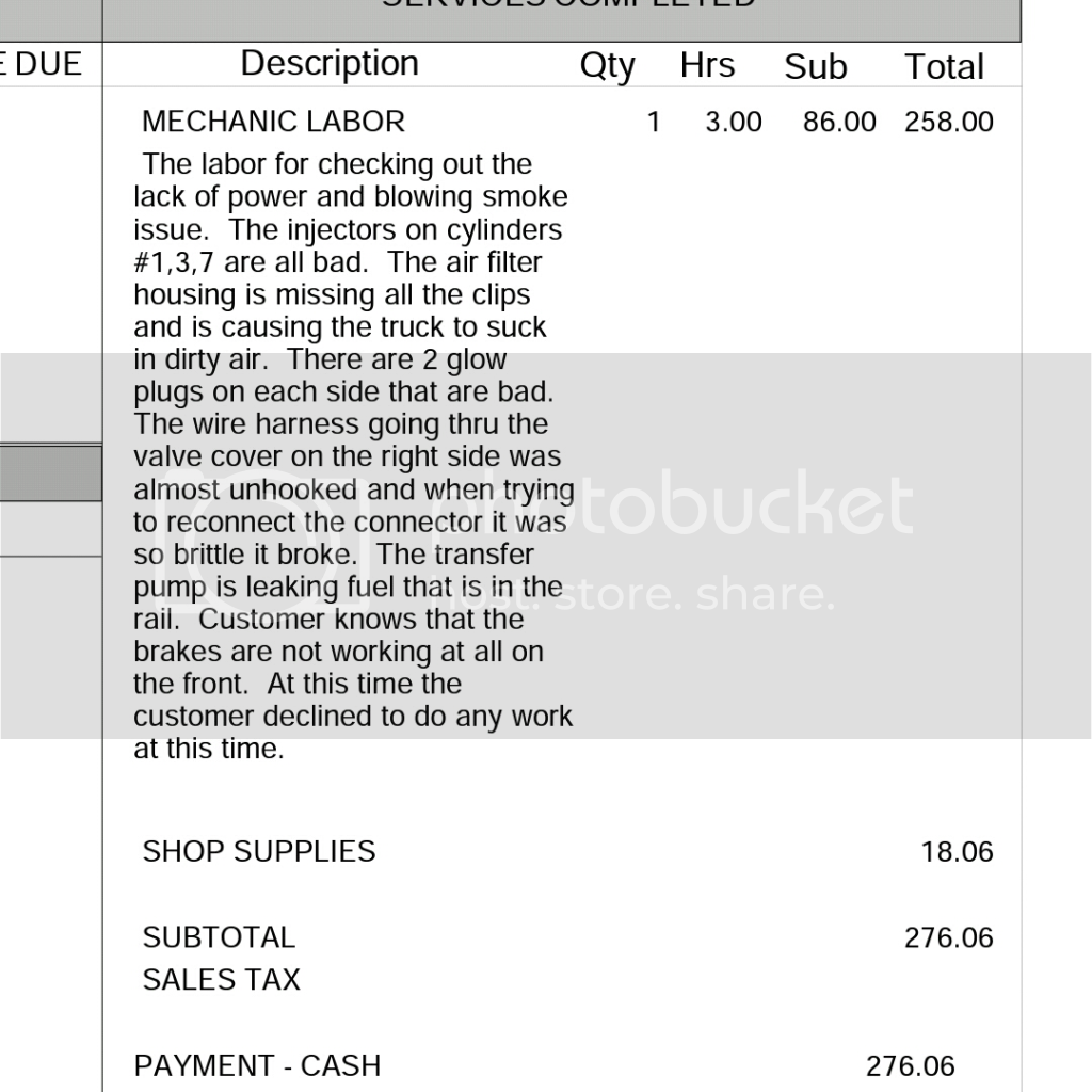

First off I'm using talk to text or whatever you call it so please forgive me if this comes out weird I was dropping a motor in a project with my buddy& while I was moving it around the cherry picker failed$
&landed on my hand.What happened next to free my hand was pretty gnarly. ..some 1940s mans man type of way.Ill spare you the details.Anyways so I finally got the correct harness & I noticed when the guy who works for me in the bodyshop pulled it that it had no breaks no chaffing etc.
So Im worried it is indeed # 1#3and #7 injectors.I looked over the paperwork the shop gave me when they diagnosed it& simply says that 1,3&7 failed the buzz Test.And that the harness on that side was almost all the way unplugged& when they went to plug it back in it broke.
So seems the harness look perfect more than likely I'm going to need to replace the injectors right? If so that's gonna suck.Well tomorrow before I put the valve covers back on can't I run the truck without them to see of its running fine? What I'm wondering as with the intercooler pipes removed can I run it like that at idle so I can see how it starts sounds? Also how can I inspect those three injectors while it's running to see if fuel is coming out of them? Thanks fellas.

Yes, you can start it and run it. Don't do it for very long. And fix that air box. 6637 filter is your good inexpensive way out.

If the uvch connections were almost completely unplugged, that's more than likely where your injector failures are coming from, even if the harness looked like it was in good shape. Change the harnesses and see if codes for injectors return. How bad is your fuel pump leaking? I would address that issue.

The repair shop's diagonsis was discussed a couple weeks ago. Lets make some progress. There are few ways that an injector would not pass buzz. You should be able to make all of them buzz whether they are good or not.
1) No electrical power to the injector. Check wiring, harnesses, plugs, etc. This is likely the issue.
2) All 3 injectors all have very loose armature screws. If loose, the armature lifts to the solenoid magnet and stays there. I've seen a few injectors do this but three on the same bank, on same truck is not likely.
3) Broken poppet spring-- not likely
4) Bad solenoid -- not likely on 3 of them
Repair and confirm that you have electrical power to the injectors.
