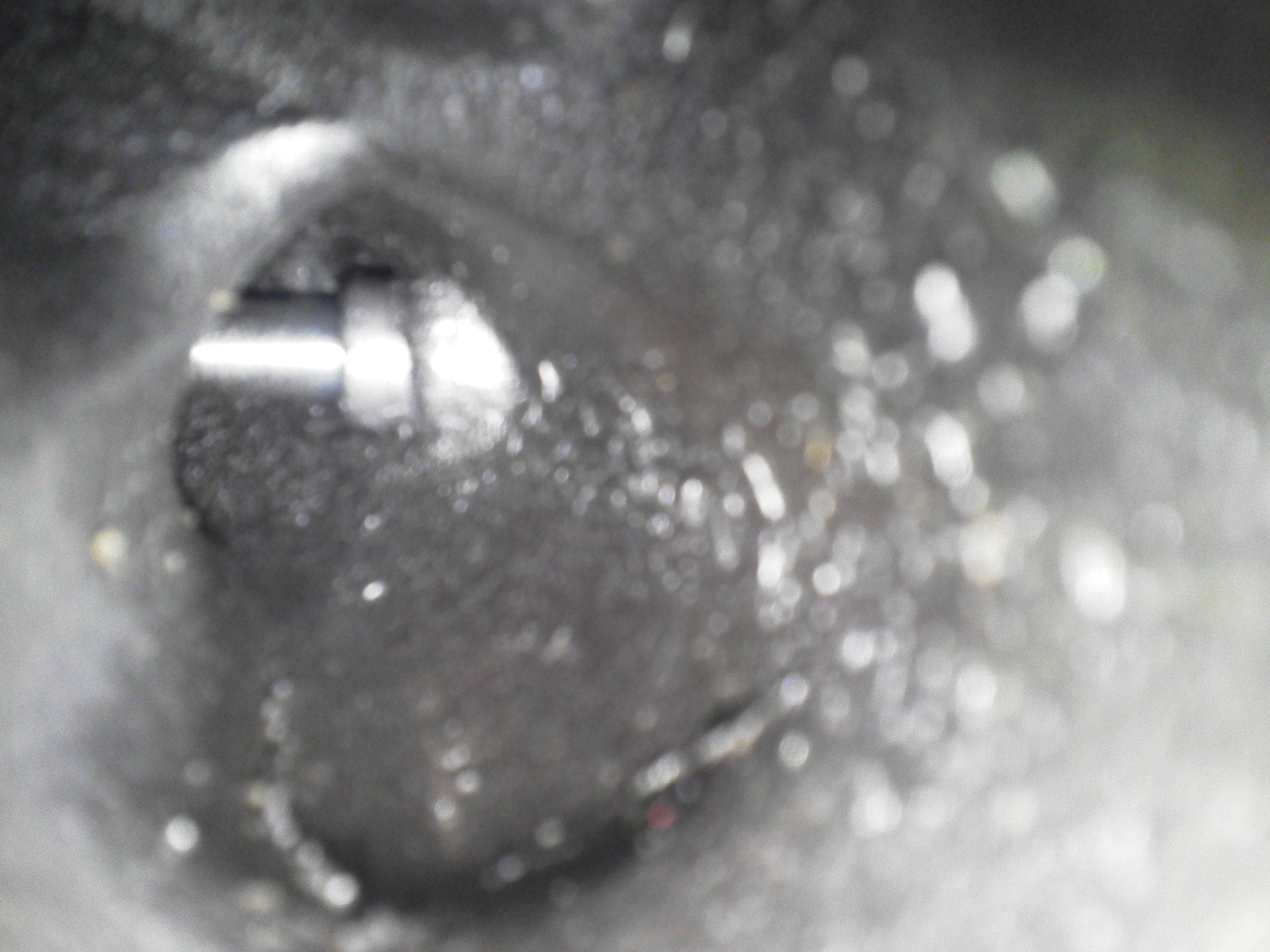

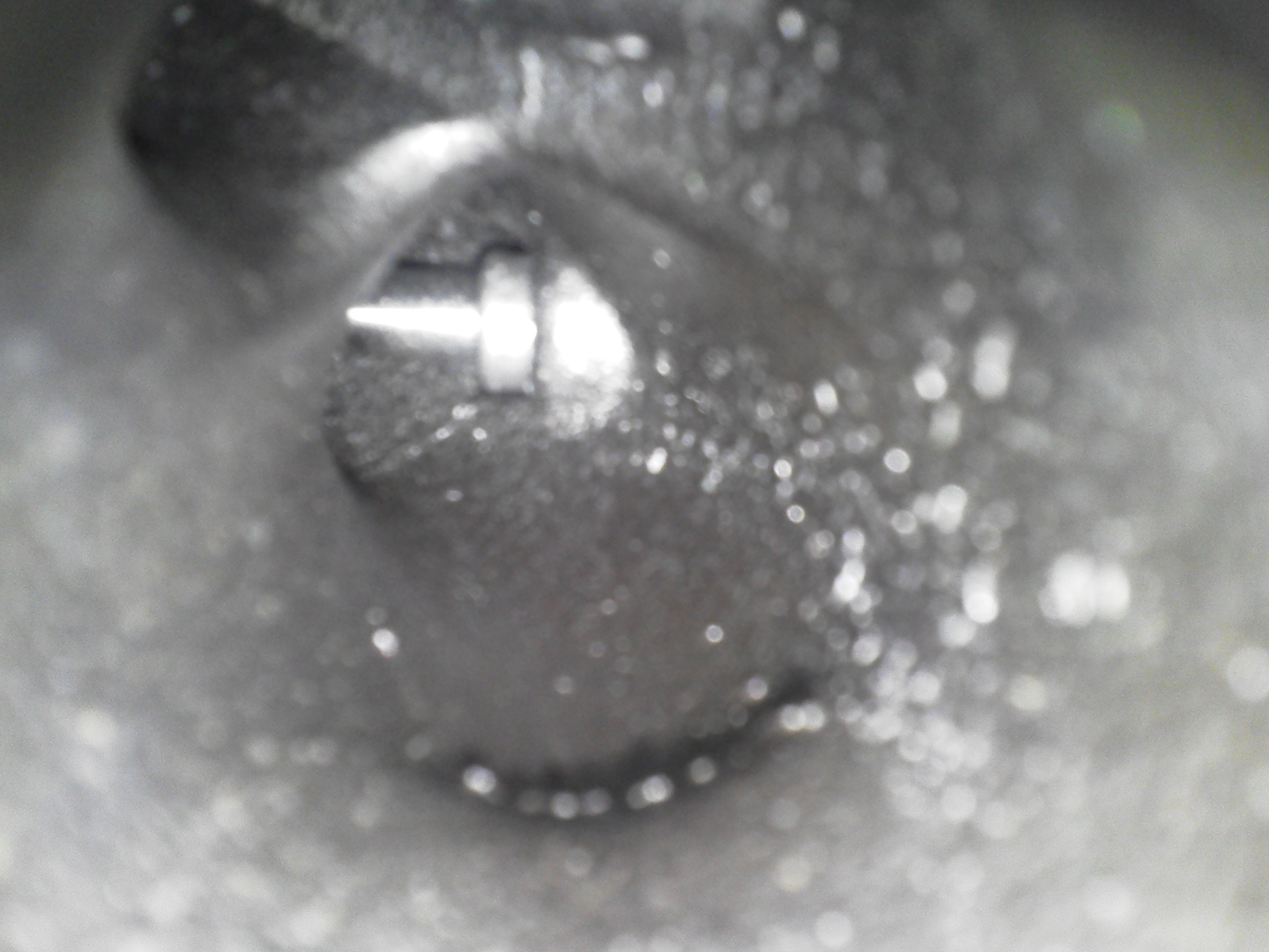

I picked up a set of heads last week for my 6.4 one measured 3.733 and the other was 3.736. One looked bad in the water jackets the other looked really good. I had them order me a new set as those were already out of Ford spec. Today I pick up my new ones and I just got a chance to measure them one is 3.729 the other is 3.736.
Am I just being too picky? would you guys run them?
This set looks good but can never be resurfaced again. I am not sure if they resessed the valves to compensate for what they are off. Maybe I'm being anal about it but I paid good money for them and they are already beyond what Ford says they can be.
You would think they could blow the metal shavings out of the ports also.

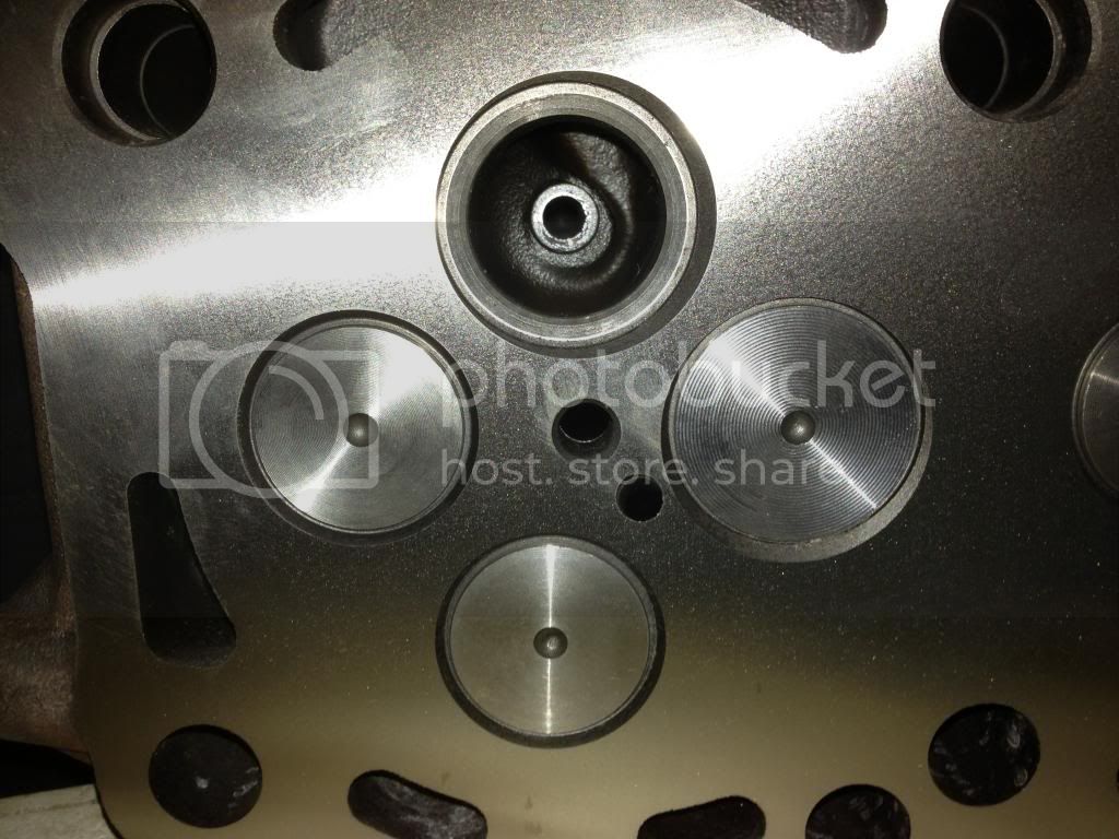

This was one of the heads I received. The valve is in the right location and seats fine but something was machined funny at one point.
If you are referring to the area around the intake valves, where they look offset?
Thats suppose to be there. It's. Purpose is to induce swirl in the combustion chamber.
