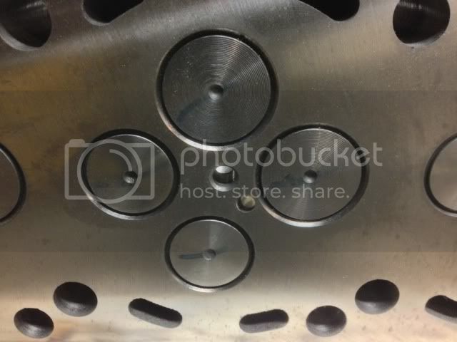

Maybe I'm not seeing what he's. Referring. To?
I think its the angle on the pic, one side of his intake valve seat area (not sure of technical term)is just cut straight, Its like the seat is just pressed in a straight hole with out any bevel leading to the valve face.
The exhaust valve on the right is the same also.

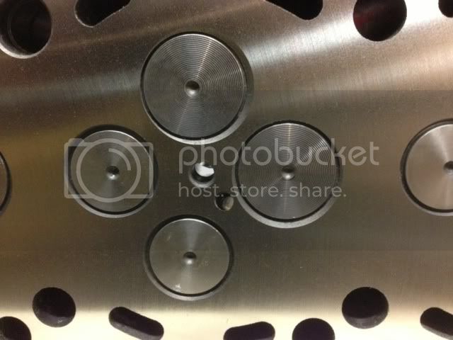

If you are referring to the area around the intake valves, where they look offset?
Thats suppose to be there. It's. Purpose is to induce swirl in the combustion chamber.
It's only that one head that I have saw like that. The other head I got was centered. It's literally square edged on one side of the valve and chamfered on the other to give the appearance that the valve is off center.

Head in question at the top. Good head at the bottom.
the bottom picture, the heads missed the machining around the intake valves. that would go back to the quality control statement i made.
it does however look like they un shrouded the valves,by chaffering the valve pockets.
however bolth heads won't swirl the incoming air charge the same. i would want a matched set of either or.
