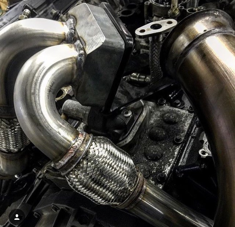

RCD T4 Mount for use with s3 or S4
:poke:
Feb 21, 2012
481
Cromwell, CT
I vote RCD, we stock s300 and s400 kits. I have also added some of our own pieces to finish the kit off really nicely to work with a Borg. The s400 kit comes with an IC pipe and a DP to finish it off nicely

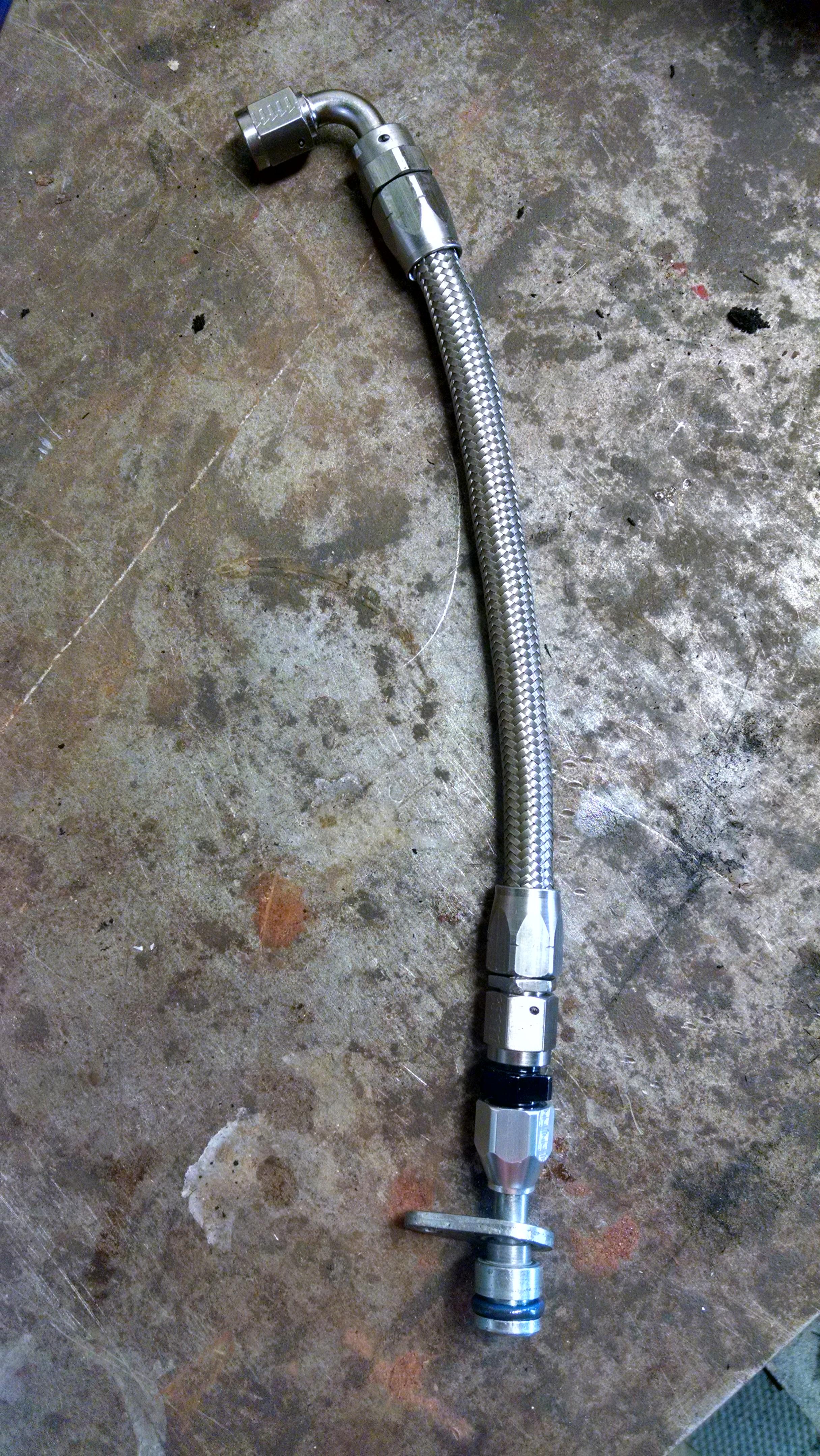

MPD has a sweet billet oil feed adapter that replaces the stock QD with a -6 fitting coming off. just get a fitting for the turbo side and some -6 SS line from a local plumbing store.
strokin6L
2,979
Springville NY
Here's one I just made by cutting the o-ring portion off the factory feed line
slc6oh
Jul 16, 2015
623
Utah
Just had the same made for me today. Prob gonna be a bit on the long side, but it looks Znd should work great!
