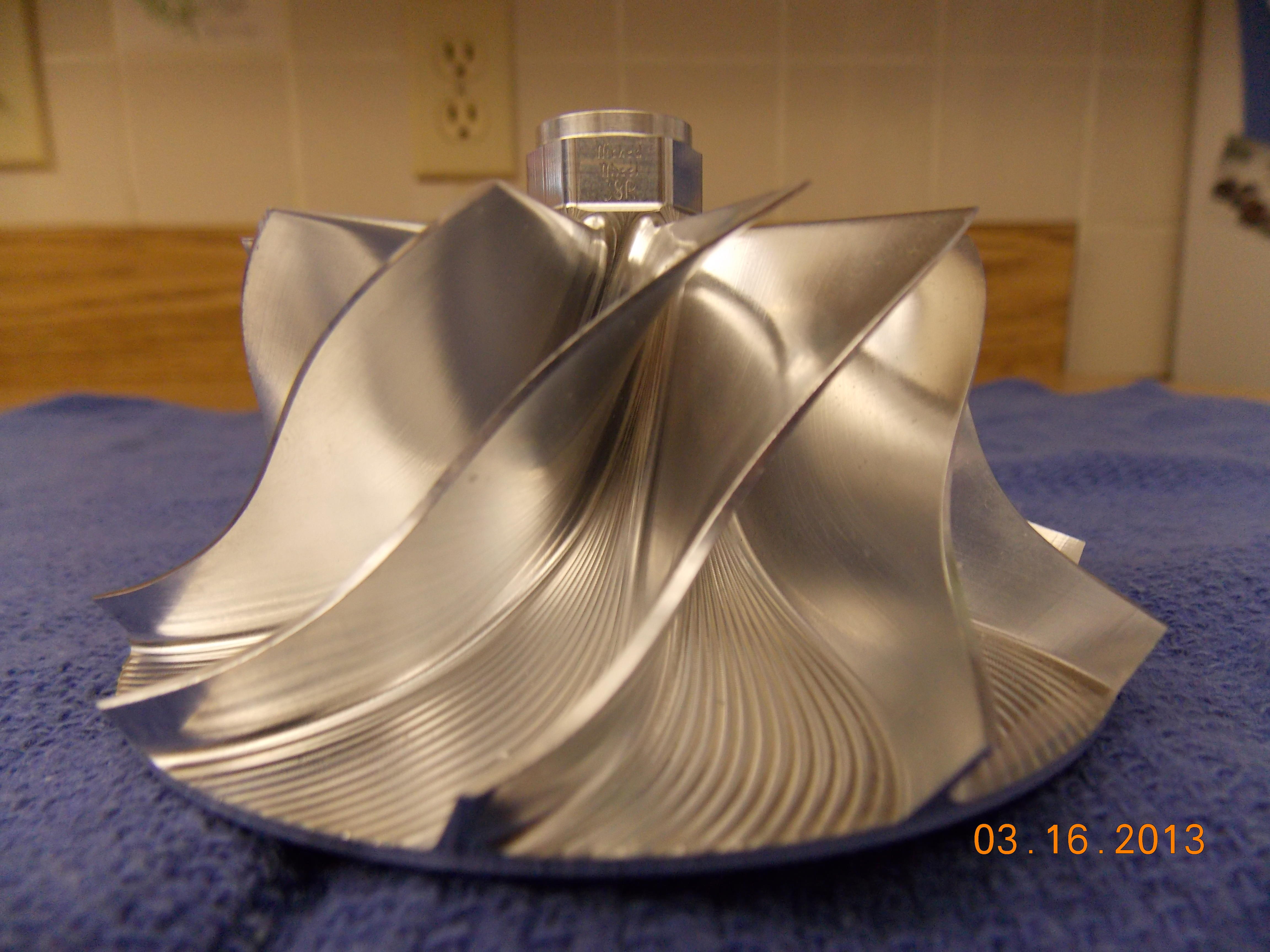

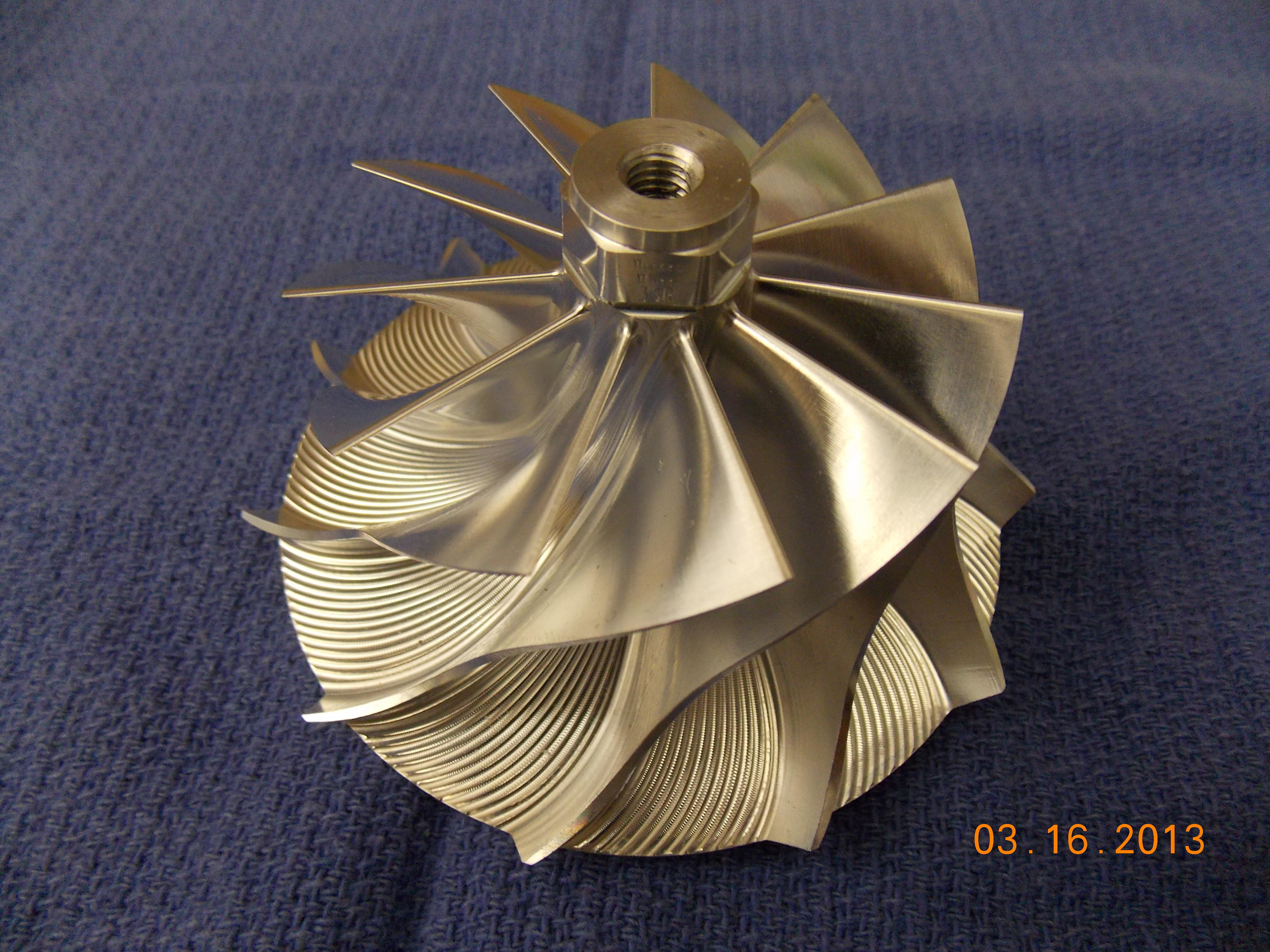

WiCkEd WhEeL 4 the OEM 6.0 Turbo Pics
Here are the pics of the Wicked Wheel for the oem 6.0 turbo.
After talking to a bunch of vendors of turbos I decided to go this route.
I would have loved to get a new turbo built for my truck but my truck buildup threw me a un expected expensive surprise. Having to get new heads wiped out my turbo funds.
So I was left with either putting the stock turbo back in or doing a budget friendly upgrade.
After a few calls to Dieselsite to gather my information, I felt this would work for my application. Bob, John, and Jennifer were super nice and answered all my technical questions.
This wheel is said to help out in the spool up and into the upper RPM range.
I'm turning some higher RPM's @ 70mph opposed to the F350's and F250's
My main area of concern is from 0-70 mph cause thats about as fast as I run the truck down the interstate.
I am in the process of putting my truck back together this weekend (heads etc....) I will post up more info and pics when I have them available.

Looks nice. So is there a need to have the turbo rebalanced when installing one of these?
windrunner408
Jul 27, 2011
1,496
That looks great man.
Yea there's no need to have the rotating assembly rebalanced when installing one of these. The wheels are balanced separately so that changing one wheel out for another shouldn't affect anything.

Got the turbo apart, pretty easily.
7/8" deep well socket on the back nut.
14mm wrench on the front wheel.
I go to put the Wicked Wheel on and low and behold they sent me the one for the Powermax GT38, instead of the one for the GT37 (OEM 6.0)
Guess it's on to other projects till Dieselsite opens on Monday..
