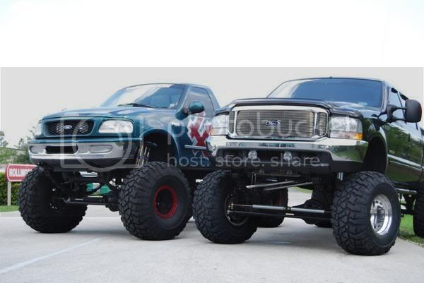

Been a couple of months did you pull the trigger on any thing yet? I am working on a few different ideas for wheels on my OBS right now. This being one of them. I seen a 3rd gen dodge running some thing exactly like this, but it was just a wide, prolly 33" mud tire.
