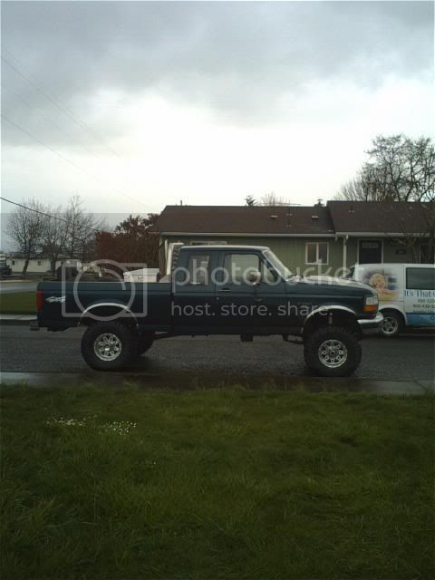

I put 37inch bfg mud terrains under it. They fit on the stock F250 OBS but the first bump I hit they would have peeled the fenders up. They looked sick though. One day. Maybe after the lift. Not sure why but my truck does seem to sit pretty high. Did they ever have a tallboy edition I don't know about?

that's 35s and a 4inch1 lift

From the looks of the picture it looks like you might be able to squeeze 37's...idk though it'd be close. But 4 inch lift on 35's seems to be the perfect combo on these trucks.
