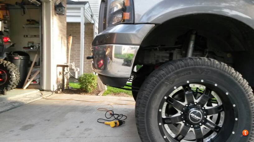

Ty, you are gonna need 3.5 inches or 4 inches to clear those 35's on 12 wide wheels. At least I did, and I still had to trim and space out my bumper.
I have some x codes I will probably never use, which is supposedly 1-2 inches over stock. Then you could find a mini pack or hanger kit for the other 2-3 inches that would be needed to clear those wheels and tires. My x codes are 2 leaves and are OEM ford springs. Then you should sit level with a f350 block or a 5 inch block in the rear or traction block set up.
Im taller than a 4" technically, and it has PLENTY of room for 35s but I only have 10" wide wheels too

It does in that picture with the bumper off, not as bad when the bumper is back on and on flat groundIt seems the rear is sitting lower the the front.
