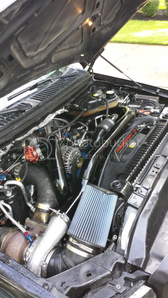

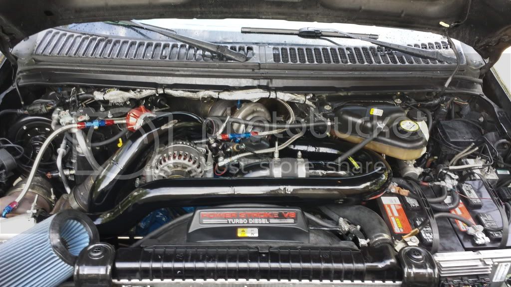

Still driving it everyday. Have about 6000 miles on the setup (58xx). Suffering from a massive oil dilution issue, have to change oil every 2000 miles. Assuming its from fuel leaking past the rings, especially on the cylinder where the rod is slightly bent. Checked injector o-rings; the heads were remans from Ford so the fuel rails "should have" been pressure tested.
I have the .83 housing on it now. Spools a hair slower than the .70, but the power gained out of it is pretty amazing. Truck will get sideways, which is a good feeling. Finally dialed in ICP with the correct pulley sizes. When you jab the pedal, it has much more torque down low than it ever has.
Will be remaking the intermediate pipe, out of 3" stainless. This time, will be using TIG. The only way to weld stainless properly.
Hope everyones trucks and ongoing builds continue to go well. :ford:

Morgan, truck keeps looking better and better. This is one of my favorite builds to watch. Hope to see it in person someday! BTW, that black on the pipes looks killer!
