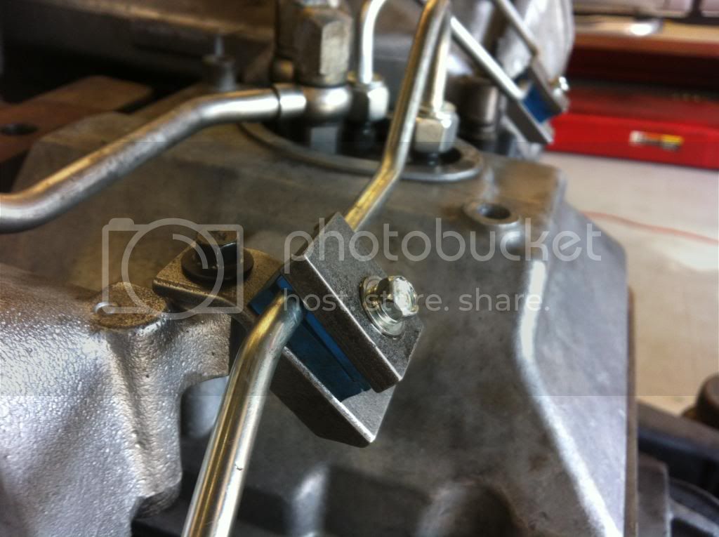

Industrial fuel line clamps that didn't do a damn thing for my harmonic fuel line issue and got in the way of the heat shield....which is where Ricky proved to be handy! LOL

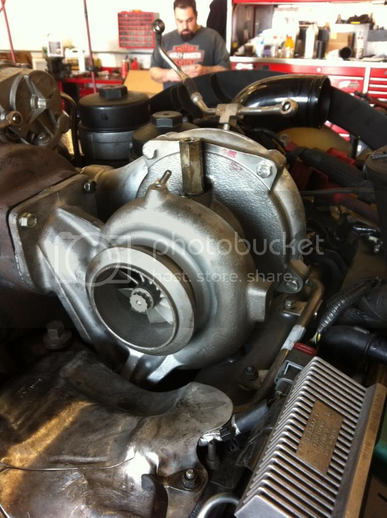

The turbo...
The turbo and Ricky texting.

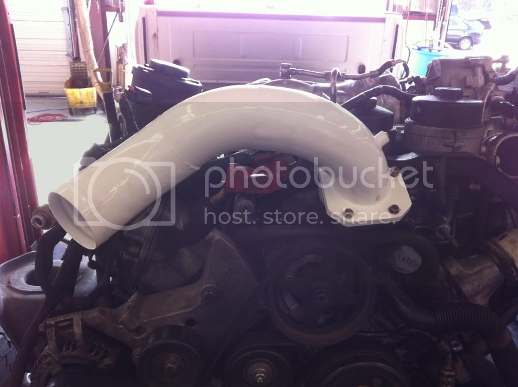

No Limit elbow
No Limit elbow and cold side pipe
No Limit cold side pipe
No Limit intake elbow and the turbo

I did the No Limit setup to replace my CFM+ intake elbow and stock cold side pipe. It moves more air than the setup I had before.

I'm so glad you like the new turbo buddy! Send me another video if you er a chance! I'm excited for you to get that thing back to the track! And that no limit pipe in white looks awesome man!
I'll try and get some videos soon. I love the white under the hood. Shone's truck is where I got the idea. As soon as I get Trevor's 3-link and traction blocks on the truck, I'm headed to the track! I can't wait!
