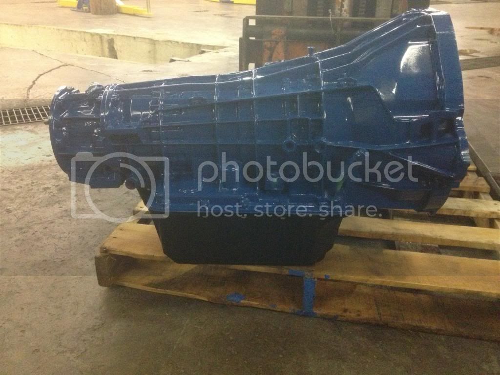

- Built Trans. w/ Suncoast Iron Pak 3 kit, billet input and low/reverse hub, MagHytec Deep Pan

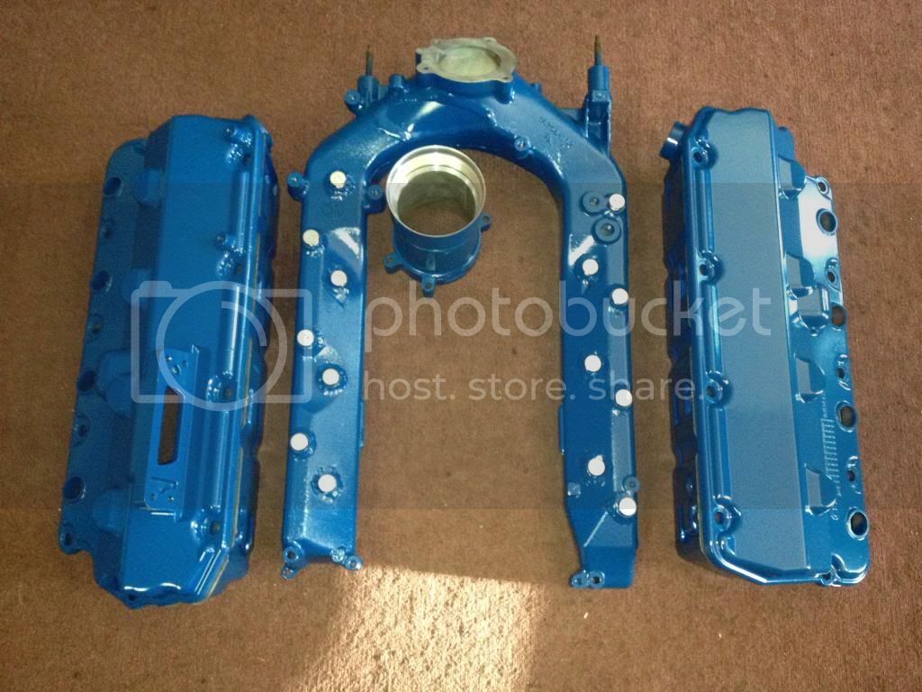

- DieselDr Intake Manifold

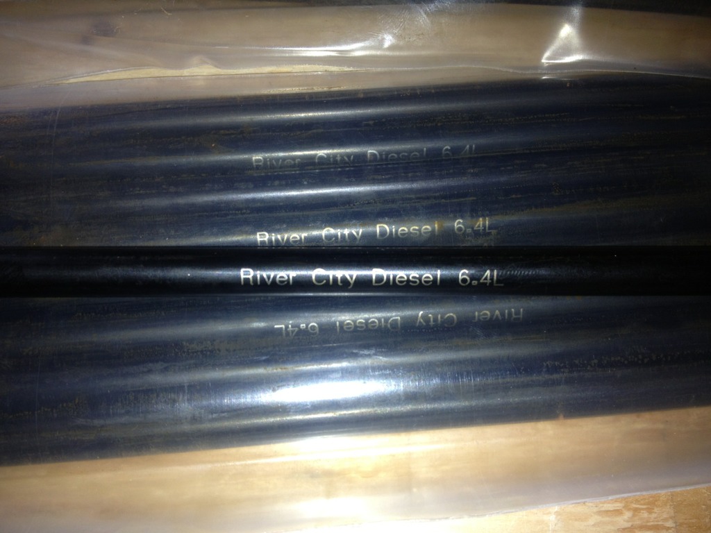

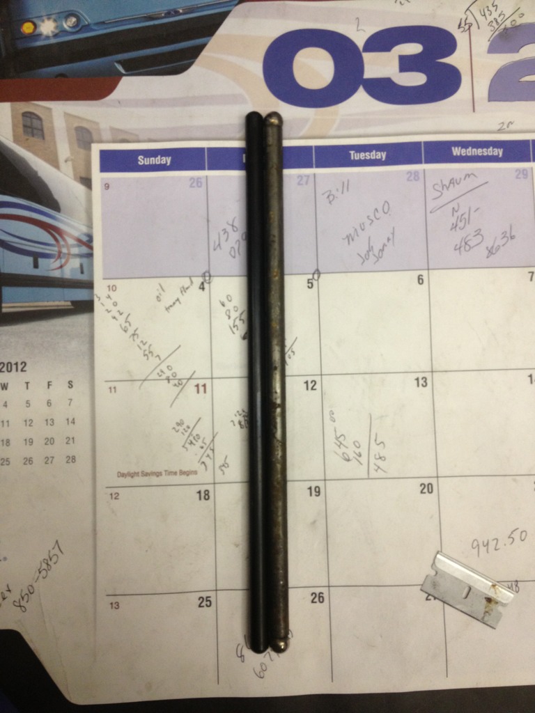

- Chromoly Pushrods from River City

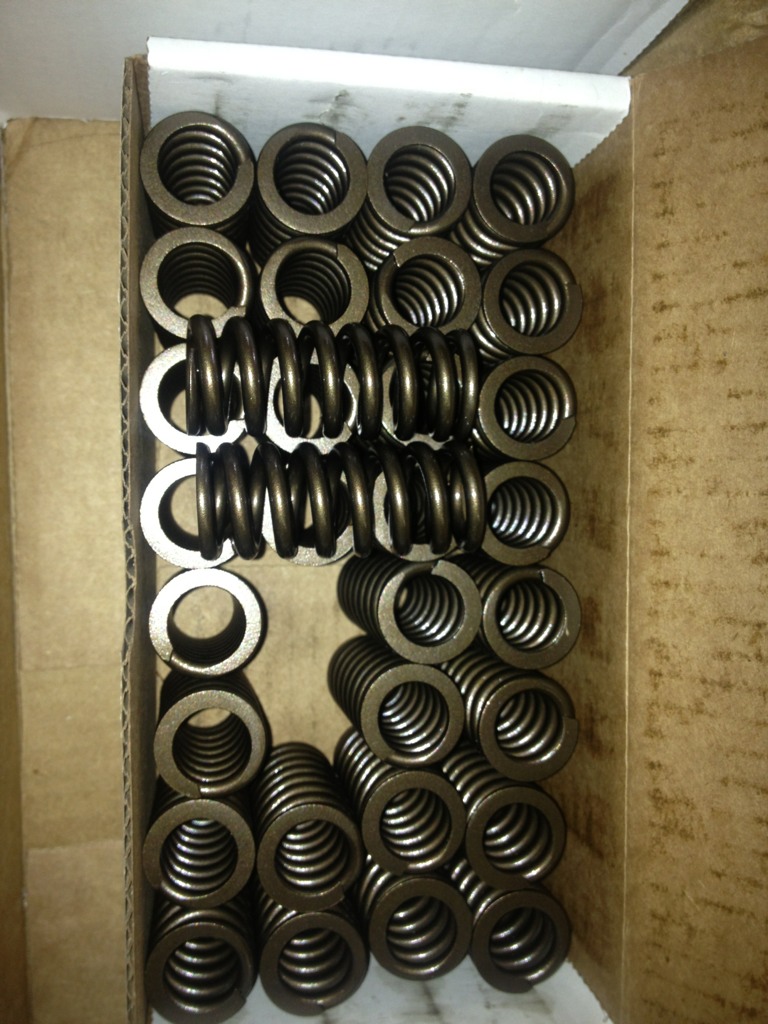

- Valve Springs from River City

tensixniner
347
Are the RCD pushrods factory length or a bit shorter to compensate for heads being surfaced?
