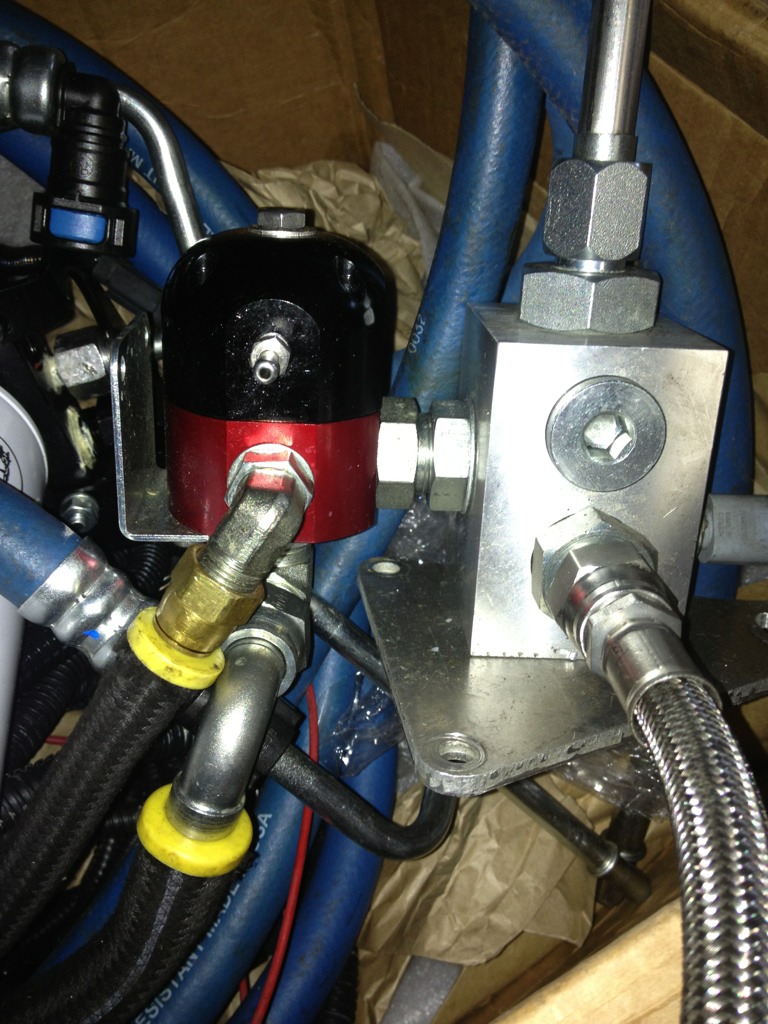

The bowl delete and air dog came in today. Going to need a little help with where everything goes coming off the main block

Found out how they all go now. I'll need another line coming off the block to feed the second pump. Since I bought this used I guess it doesn't come with everything I need for dual fuelers. And also a return line for the second pump. Where exactly does the return off the second pump need to go? Can I "T" it in to the return off the regulator?

or does it need to go to the back of the fuel cooler to be cooled? if it needs to go to the fuel cooler where can i find the right style of fitting for that?

shouldn't the regulator have a second return port? I'm just assuming. Either that or I imagine you could T it into one line. I don't physically have all of my fuel stuff here yet so I don't know until mine arrives.
