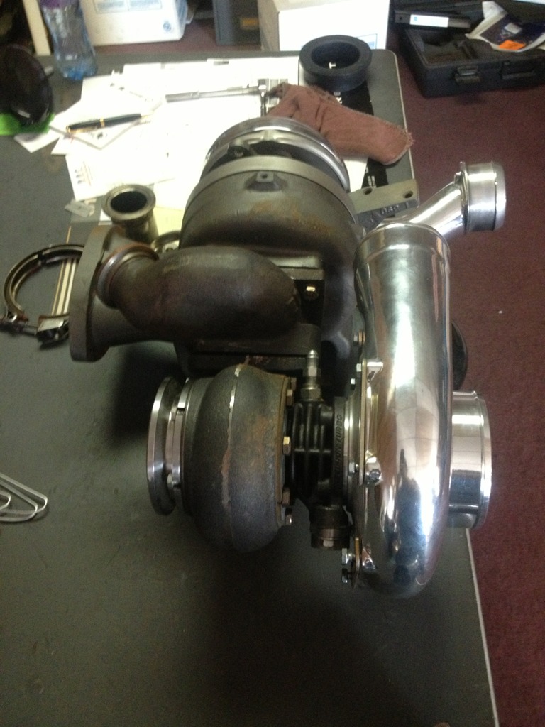

got the oil lines, wastegate dump plug for the 76, and an intercooler boot for the crossover tube ordered today from elite. dual fuelers are shipping tomorrow. up pipes and CCV delete should have shipped today. still need to round up the needed fuel line fittings and theres a local parker store so i should be able to find everything there.
probably going to take the casting between the 2 turbos and the 6.0 manifolds to get hi temp coated locally soon.

Took the exhaust manifolds and the casting between the 2 turbos to get hi temp coating put on...bad news is they are 10 days put on work so everything will be getting pushed back before I can start.
Oh well still have a few things to get rounded up and sorted out
