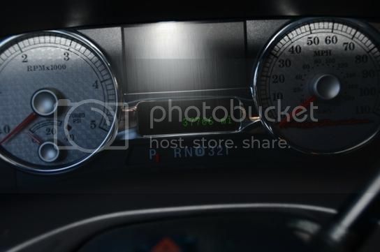

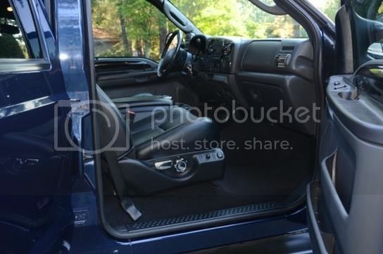

Since then I have been in a 2013 F150 FX4 Ecoboost and a Dodge 2500 24V Cummins 6 speed. Needless to say both of those trucks lasted less than a year each. I never got over my 6.0 and decided I needed to get back into one - which speaks volumes after what I went through. I am having a 2005 Harley Davidson edition 6.0 shipping from across the country in the next couple weeks. She is stunning - only 38k miles on the clock. Every possible option Ford offered in that model year.
I am starting this thread as a way to get back up to speed on the latest and greatest for the 6.0s. I would like to see if the technology back when I put these parts on my first truck 5+ years ago is outdated and what the best newer systems running today are. I know a lot can change over a couple of years. The truck will eventually be moderately built. HP goals around 500-550 tops. I want this truck to last and not cost me thousands in repairs. I want to make sure I am doing everything right the first time - and only putting the highest quality parts on this truck.
