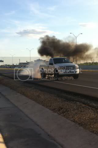

Put a stack on the truck last week, Here is a pic of a little burnout to test it out......Trans, Turbo, and Fuel system still strong........
