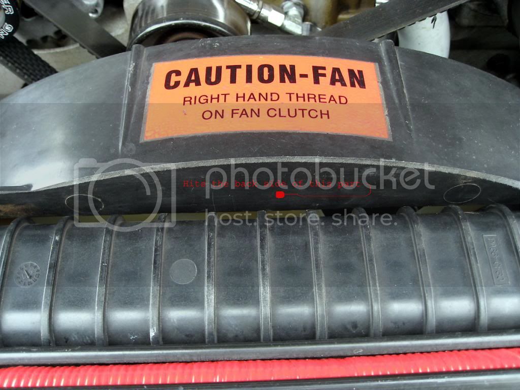

I took some pics. Here is the shroud looking from the front. See towards the top on the front face how there is a section of plastic going straight across. This prevents the round opening from going all the way thru. I think it's there to block the fan from pulling air over top of radiator.

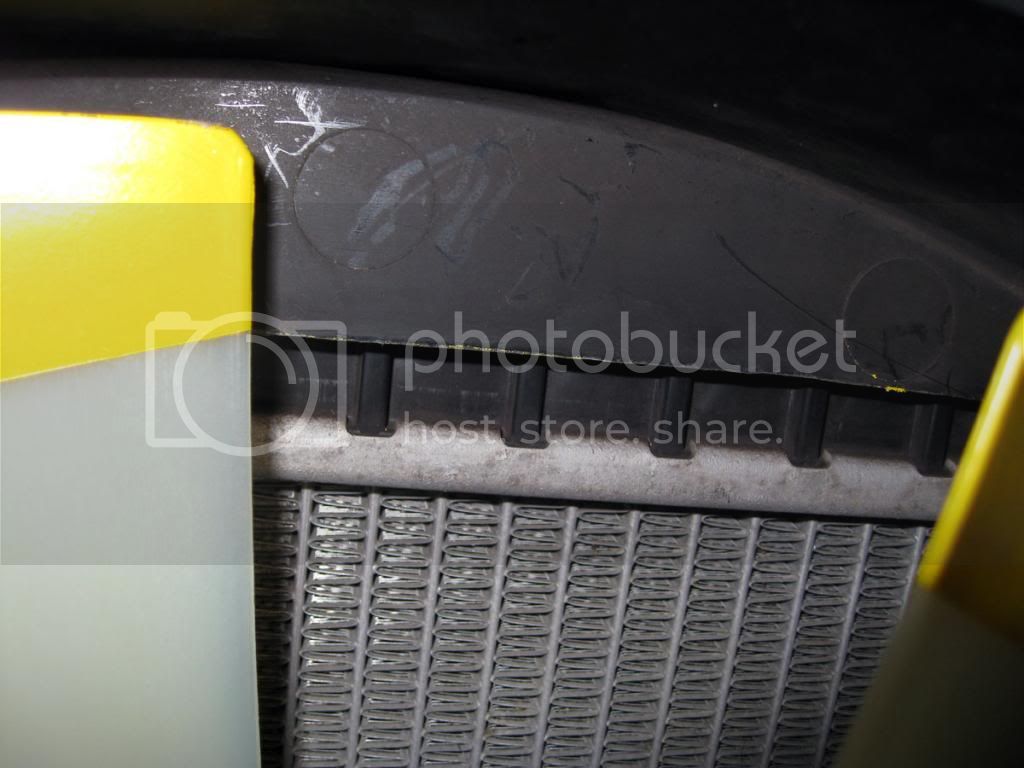

Here is a pic from the backside. You just see a trace of yellow paint where the fan rubbed.
I need to shift my radiator over to the driver side some. There is about 1/2" clearance that side but almost 1 1/2" on pass side. Plenty of room on the bottom too. But even with the shroud as far up as it will go I still cant get a finger between it and the blades.
There has to be a way to jiggle things around here. This fan is way too good to just give up on!
