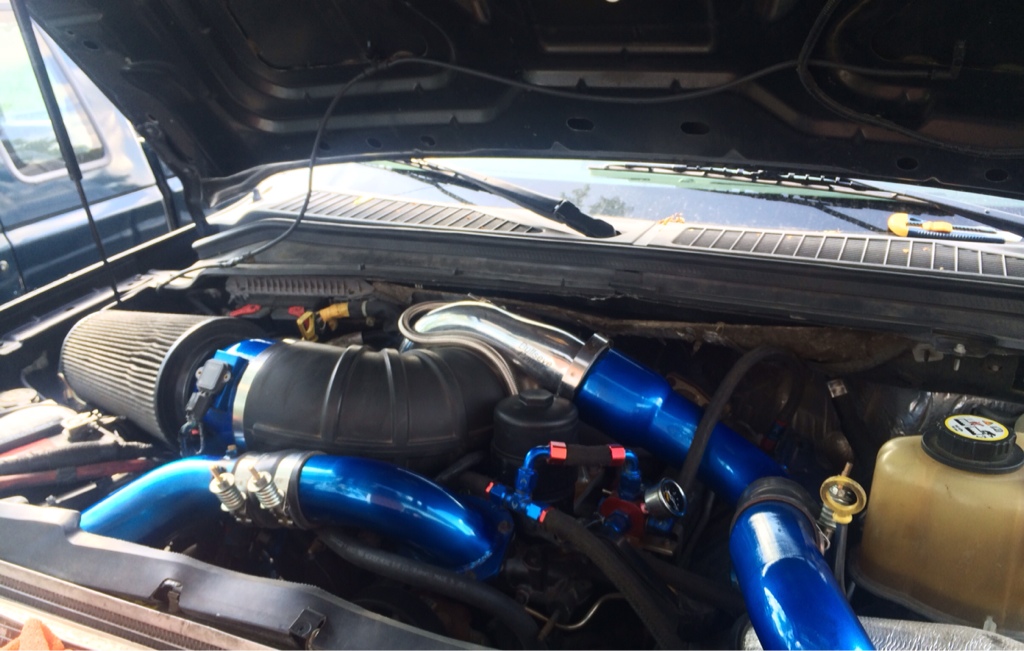

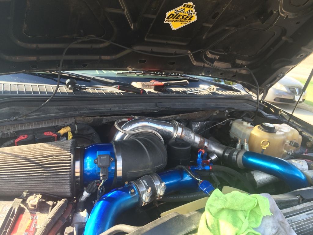

Well decided I'm going with a grizzly locker in the front and machined stock axle shafts, finally getting around to sending my f***ed precision converter back this week so hopefully getting warranty on it!
Re painting my intercooler pipes and a few other things in the engine bay, the winter wasn't too good for it sitting outside for 4 months! Need to put back in my e-fans and clean up the wiring as well.

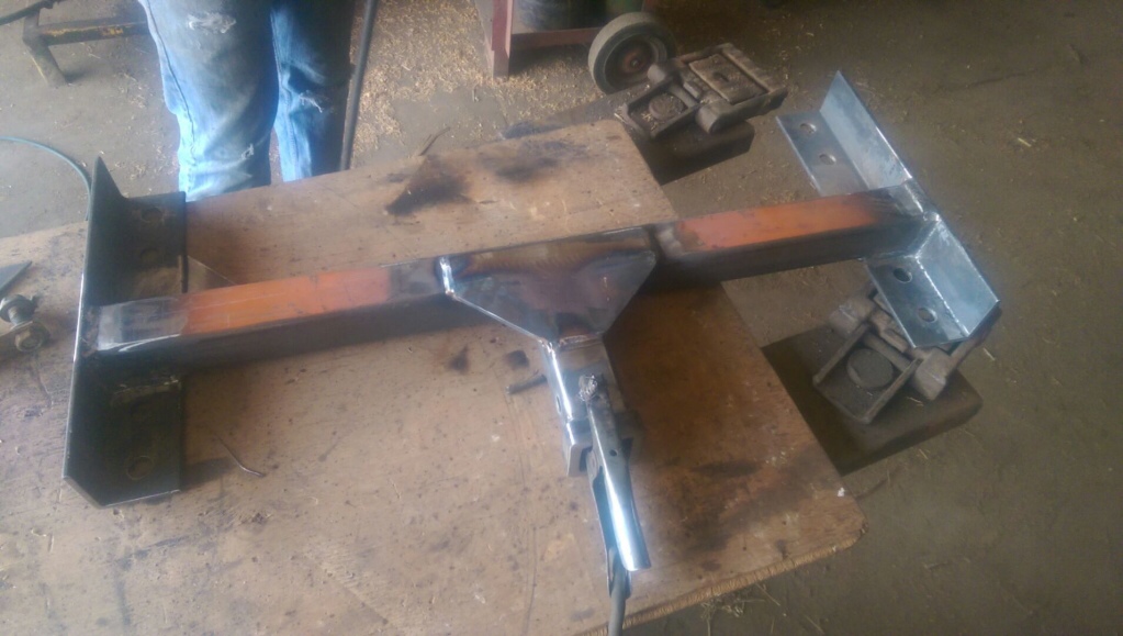

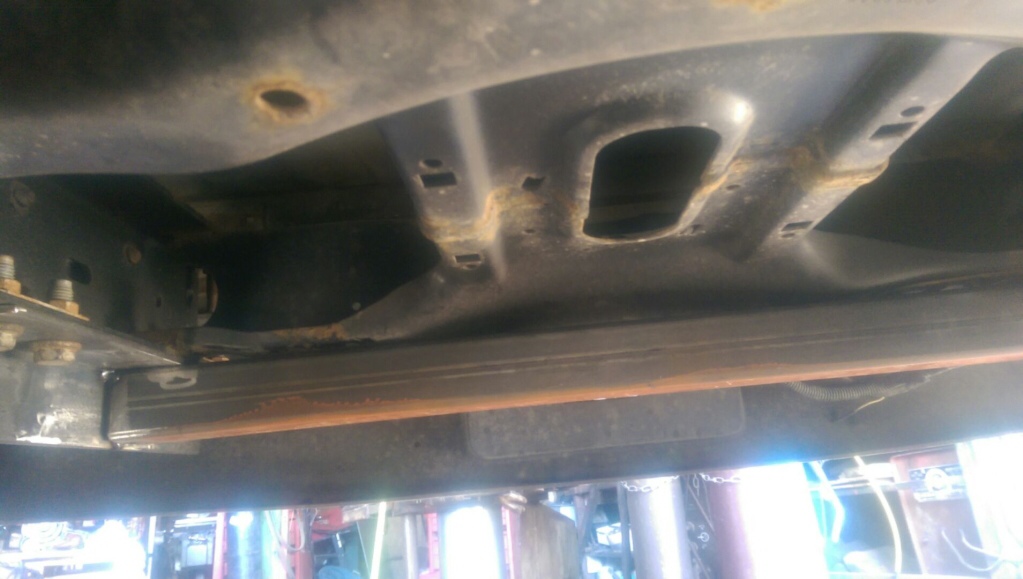

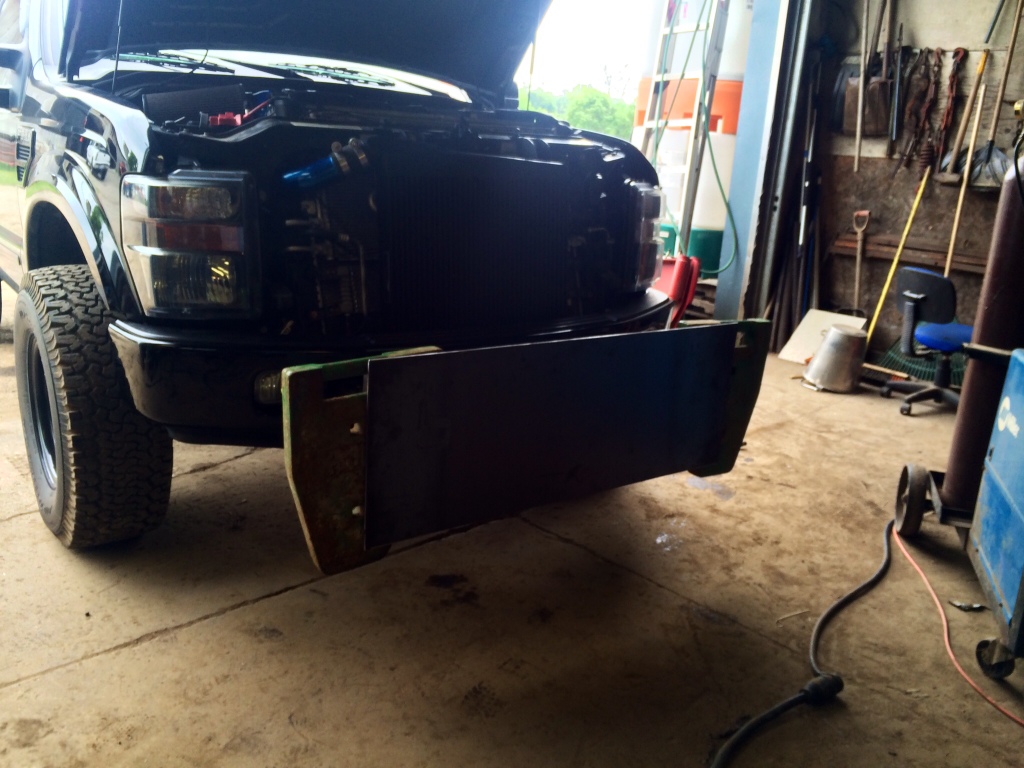

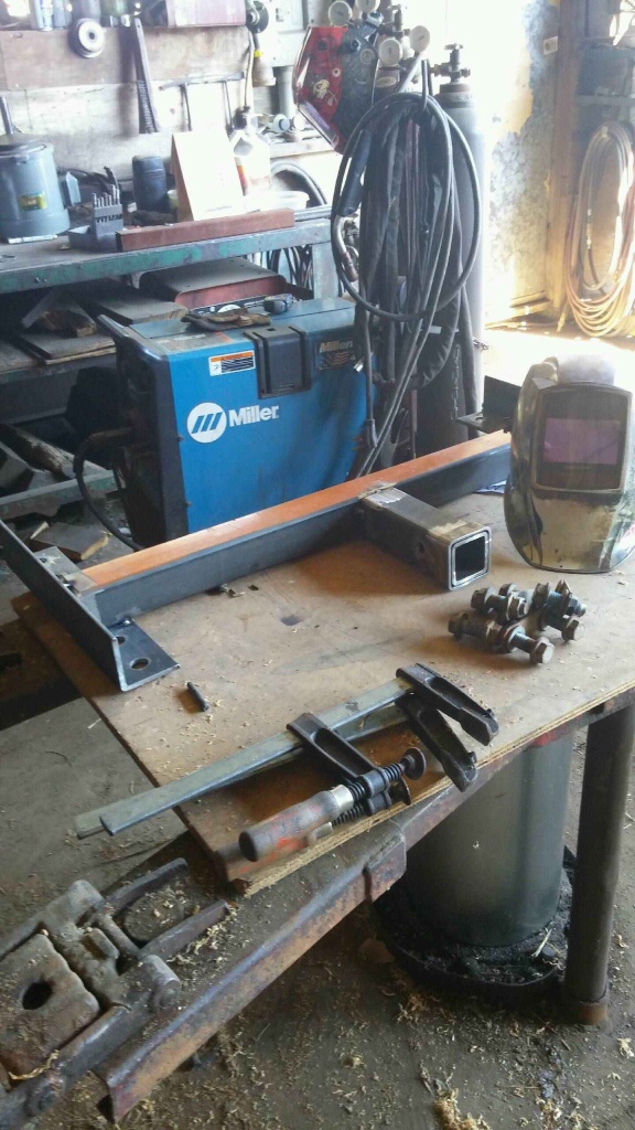

New hitch is done, nothing too special, mounts to the stock hitch location and comes out the roll pan licence plate hole, pretty happy with how it turned out!
Finished product, just needs a coat of paint and it goes on the truck, weight bracket is next.

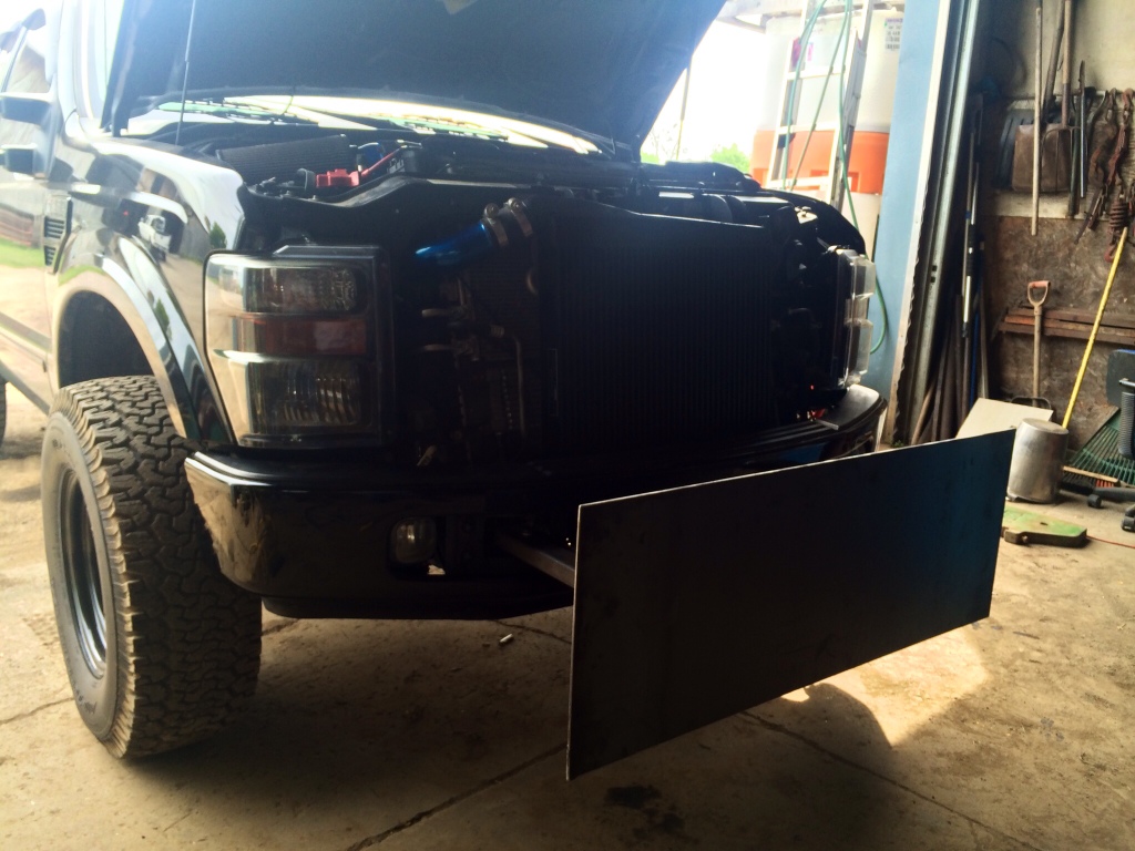

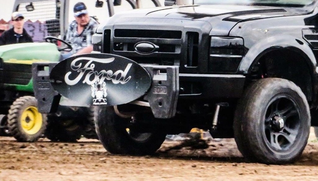

Looking good! How do you plan on mounting the weight bracket to the truck?
Thanks! and probably going to do similar to what you've done with a receiver where the tow hooks went, then they're going to do 1/2" plate coming off the receiver so I can hang weights off either side,with a flat steel plate on the front to display the trucks name and hopefully some sponsors. Will look similar to this but the plate won't be oval shaped.

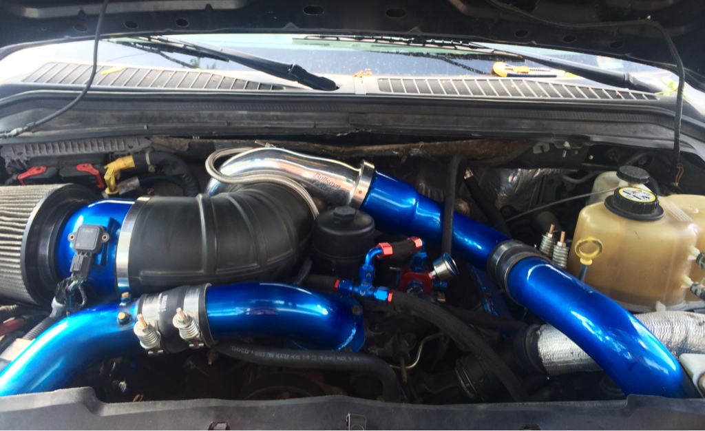

Where did you get the 90* elbow for your turbo? Is it 5.5"?
Nick284
Nov 16, 2013
211
Buffalo NY
i did the same thing. 5.5 elbow off of a dump truck. works great, looks good!! cool build, ive been reading along the way!

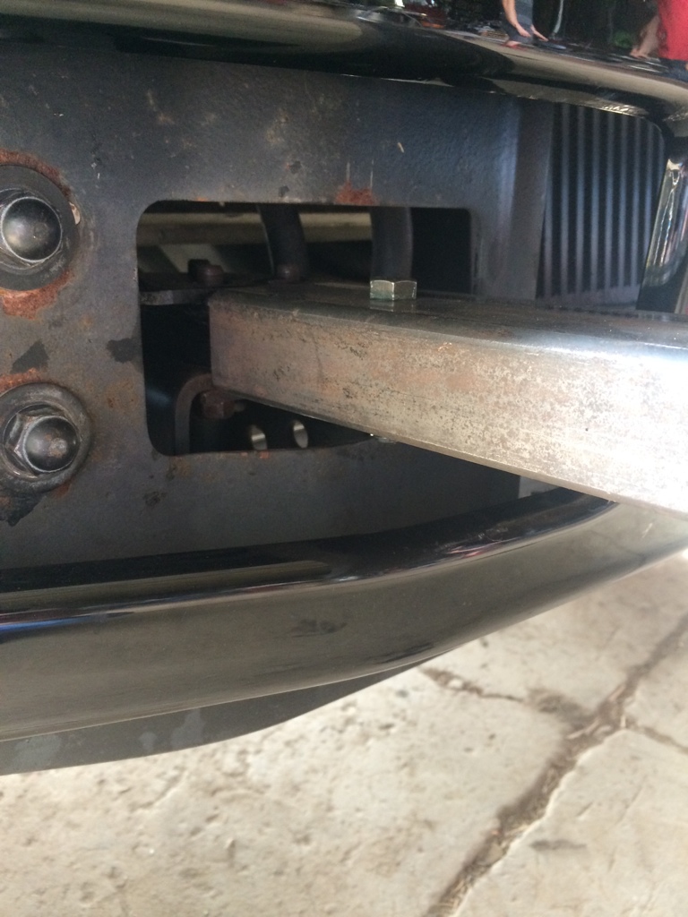

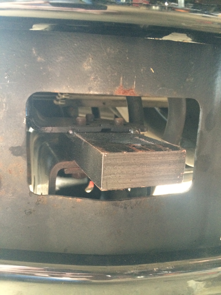

Pull was rained out last weekend unfortunately. But was able to get the weight bracket done this weekend just needs painted and the logo done up for the front of it, tuned out great though.
They cut out the tow hooks and machined the piece to go in place of the hook, bracket just slides on and a bolt holds it on.
