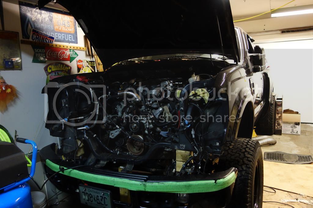

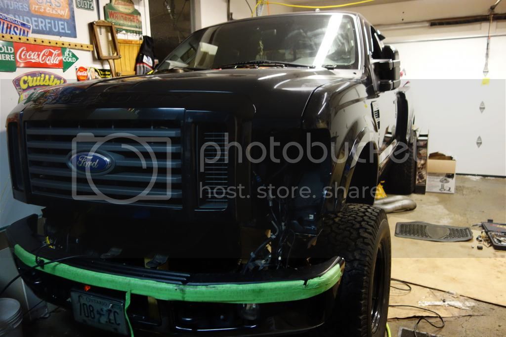

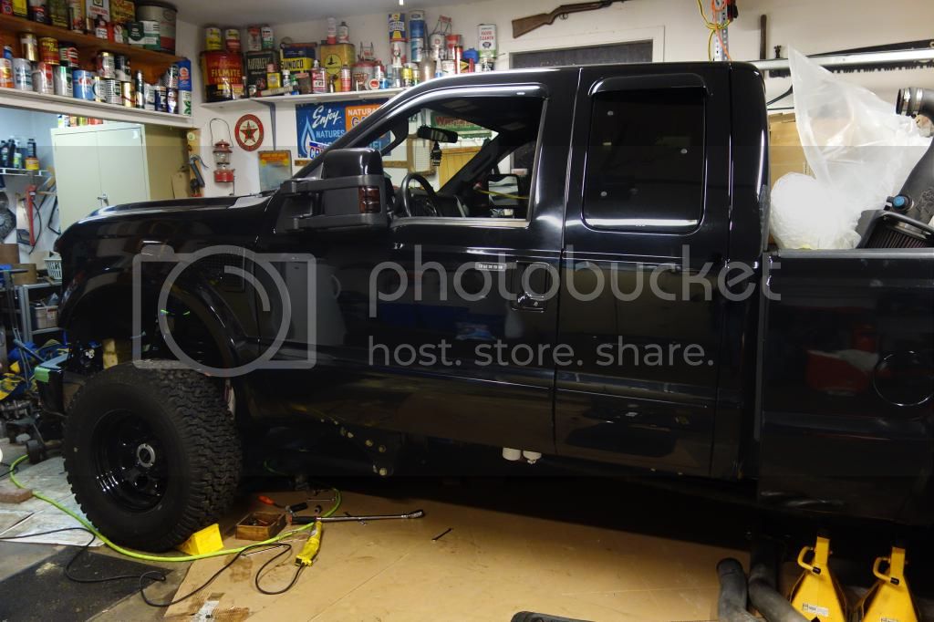

Little update, weather got a bit warmer so finally got around to getting some work done on the truck, lifted the cab up 8 inches or so and the motor and trans are finally ready to be pulled out the front and get some real progress going on this build, hoping to have it out next weekend just waiting on a engine stand!

Looks good man it wasnt bad pulling the motor from the front was it?
Lol yeah that's next weekends task hopefully, so far it looks like it will be easy, the extra 8 inches from lifting the cab up are worth the time it takes to lift it, if you can get heat too the cab mount nuts up top it helps a lot.

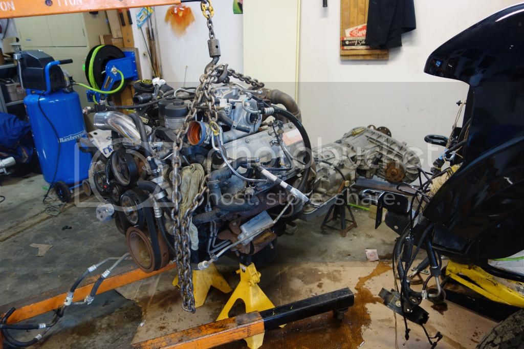

Got the motor pulled today finally!! Torque convertor, ati damper, arp rod bolts and no limits intake should be arriving soon, pistons and cam order next week hopefully!

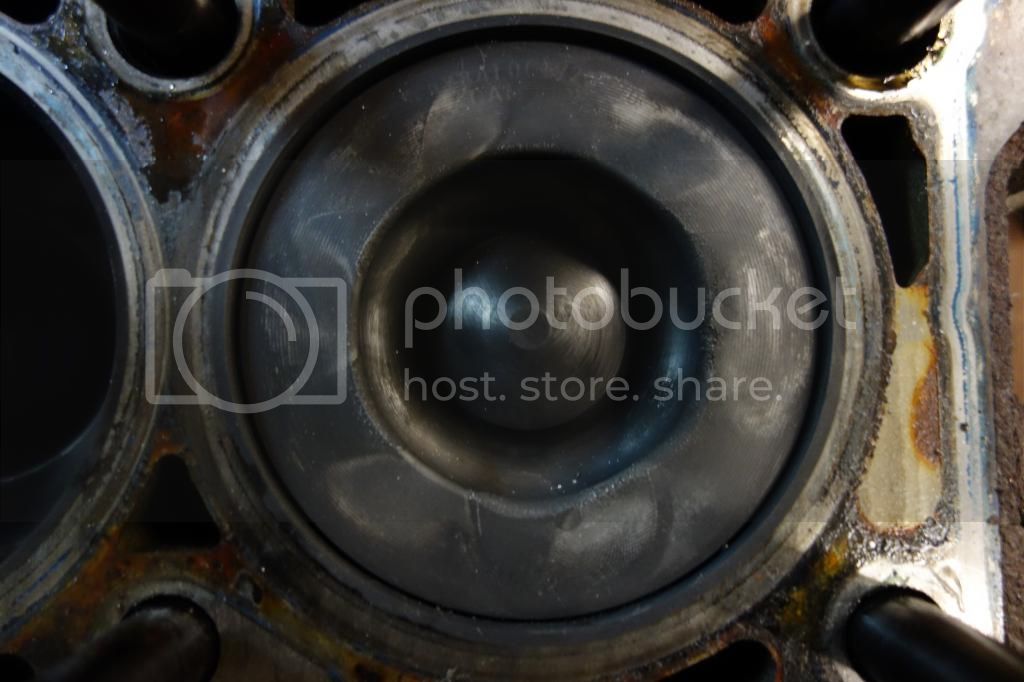

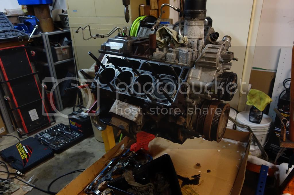

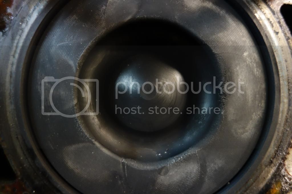

Got the engine tore down mostly today, found one of the pistons looked like its been getting a little toasty.
Looks like it may have kissed a valve at somepoint too, hopefully my new pistons from Morgan will fix this ;)

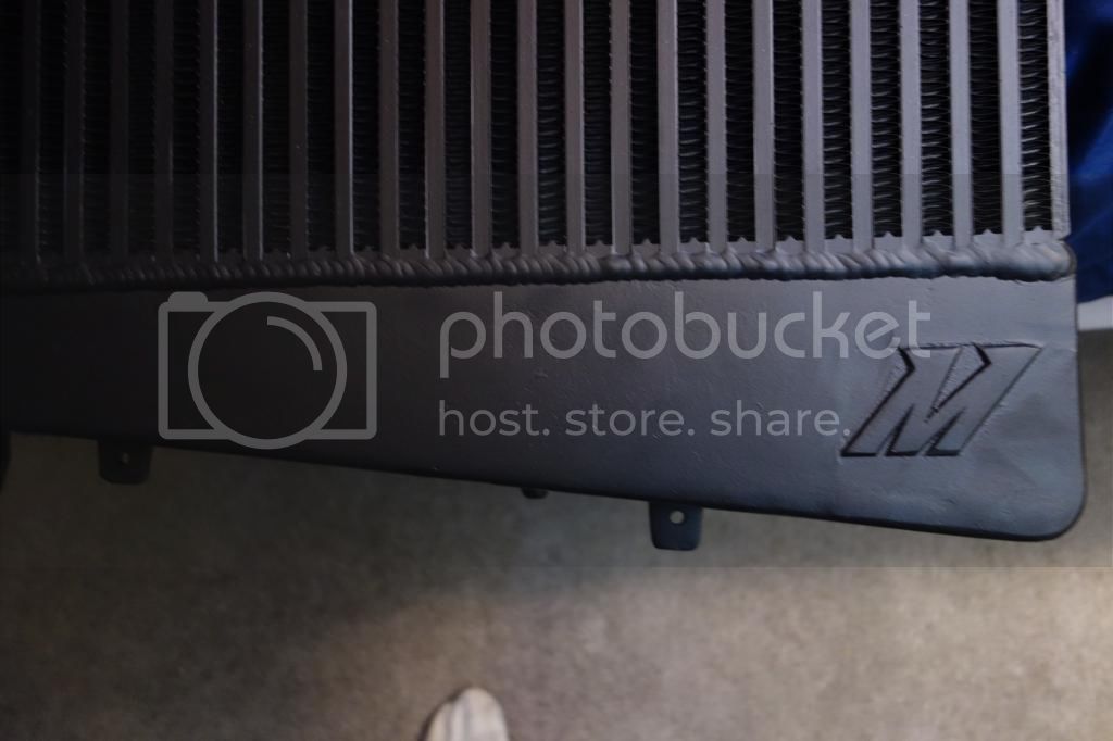

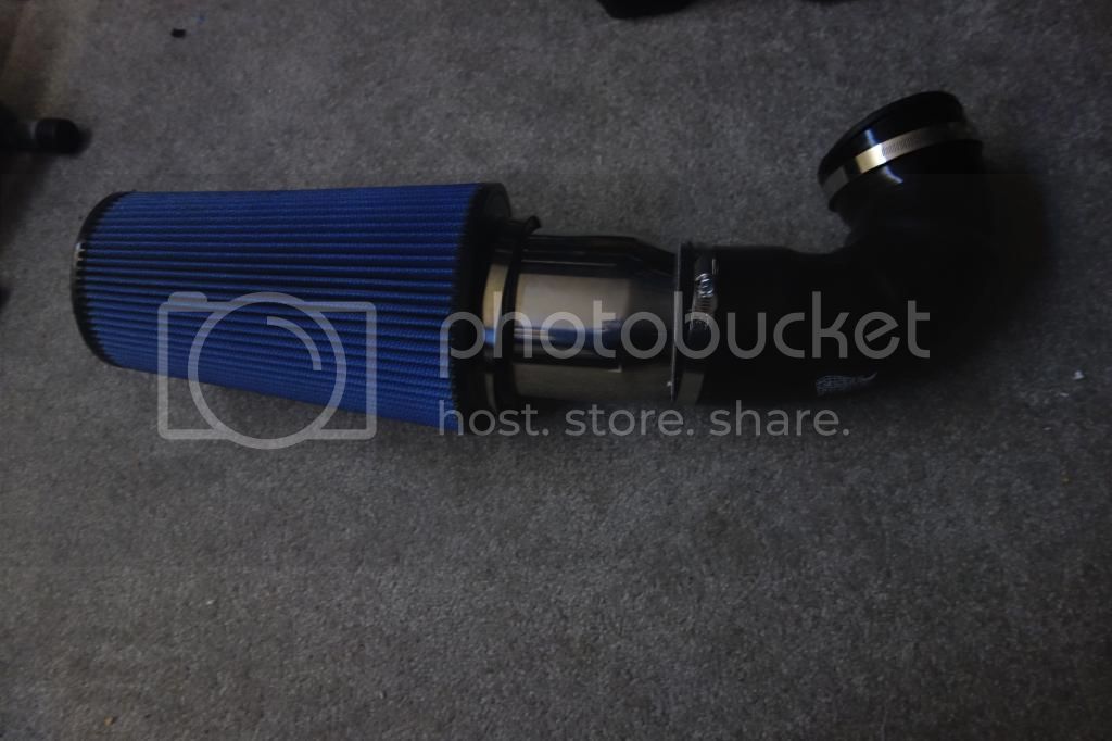

Got this in today too

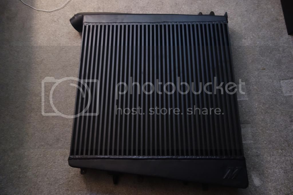

And this last week, haven't seen many guys on here with this intercooler but I figured id give it a shot, extremely happy with the quality of it.
I see you have faith in your engine stand! I don't... I made a brace that holds the front of the engine from sagging too far. Maybe someday I'll buy an OTC
