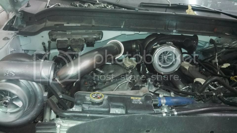

Look out for that PCM connector next to the intermediate pipe
They'll get ya every time!! Haha but seriously that's an optial illusion, there's lots of room, and for extra protection ceramic coating and heat wrap! ;)
Are those the manifolds from the previous setup?
Nope :) those are MPD pieces!

Is the lp charger partially mounted to the egr delete plate?
Yeah
