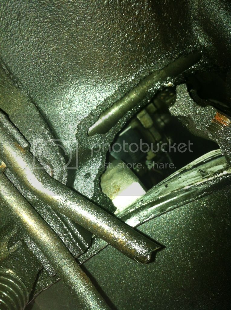

man i just crawled under the truck for another look and it seems it blew out the other side of the block as well.. I bet once i get it torn open its going to be NASTY in there

Little somethin like that
