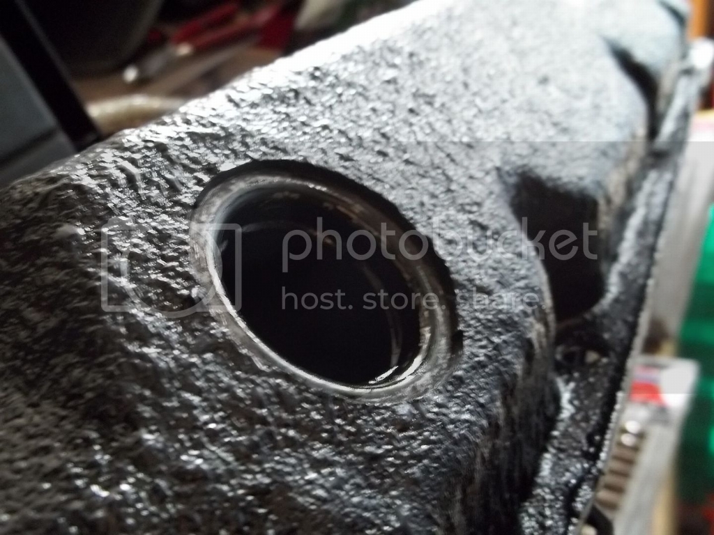

Got them on last night. Photos are uploading now.
To give you an idea, I weighed the stock and coated valve covers. Stock RH was 39.10oz, coated RH was 51.20oz. Stock LH w/ CCV was 59.65oz, and coated LH with CCV (which also got coated) was 69.15oz.
I also have some sound clips I'll try to figure out how to get uploaded. May just put them in a video with captions. But that will have to wait for tonight.
Haven't really driven it yet to be able to get SPL readings.
cowboy_dan
485
Brownstown, pa
If you look carefully in the last picture, you'll see I cleaned out the area where the boplt heads go. I tried putting the bolts in with the liner still there, but it wouldn't torque down. The liner kept acting like a spring: I could tighten the bolt down, but it would loosen the bolt as soon as I let up on it. I suspect that is a characteristic of all the liner types. So I had to sit down with a utility knife and cut a sorta-circle and pry the liner donut out. Believe me, this liner is tough to cut.
