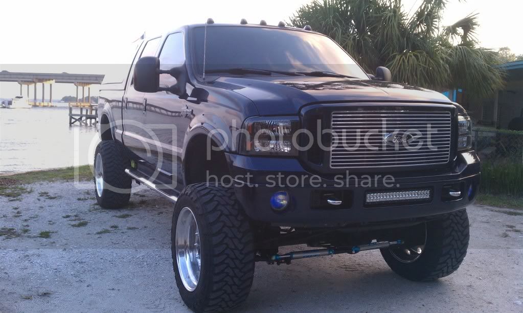

very sharp/clean rig
Is that a RIGID Industries LED light bar in the bumper? I was thinkin about getting a 10" one between the factory fogs.

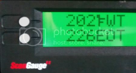

I have been running my BPD kit now for over 12k miles and my ECT temp varies between 188F and 200F depending on the driving and outside temp. It gets pretty warm here in Memphis (106+F everyday) and I see 208F all day long for my EOT and this is with a 215F thermostat put in the mix. Since the oil temp is being measured as the oil comes back to the motor, that is why my oil temps are lower than the thermostat operating temp. The oil going to the thermostat is 215F or higher I am sure. I also dont tow much but I am confident that this will handle my 12k lb towing weight should I ever need it.
Your running the right configuration and don't tow heavy by any stretch (assuming you still have stock 3.73's or have changed to match the tires to that or 4.10s). Its only in the lower geared trucks that run higher RPMs for the speed (F350 TowBoss, F450, and F550 trucks) that there becomes issues with the BPD external kit. Two solutions, a SCT file with fan engagement on EOT, or the new coolers BPD is in the R&D process of designing.

As to tuning, any tuner should be able to make the adjustments. My recommendation, is have the fan clutch on EOT at or about 220*. If that proves to be running the fan for you, shift it to 230*.
The truck
The problem
The solution
