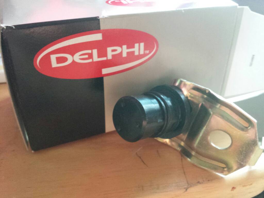

looky what I found

Must I explain.......finding a black OEM sensor.
Billy T.
[email protected]
That was a total accident too.. when I was looking on amazon I ordered 3 cps's from various places. one was the delphi grey but the pic showed a black. the other two where a bw and a no name but those are built like the old style fat end blacks but not as strong magnet wise. the black delphi I ordered on accident by bumping the one click buy/ship option and I didnt mean it. so I ordered 2 more on purpose hoping that they will be the same oem black...

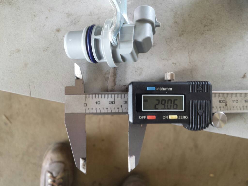

did some comparing and holy fugin chit. its a ton of difference. I mean I always knew how much difference there was but when I actually tested it out, its amazing. these are the last size drill bits that the magnet would hold for each cps.
I measured the hight and I actually thought that the black one was shorter but it turns out that its a hair longer and I am wondering if it was the reason that the shims where used so I may need to shim the old style even more.
