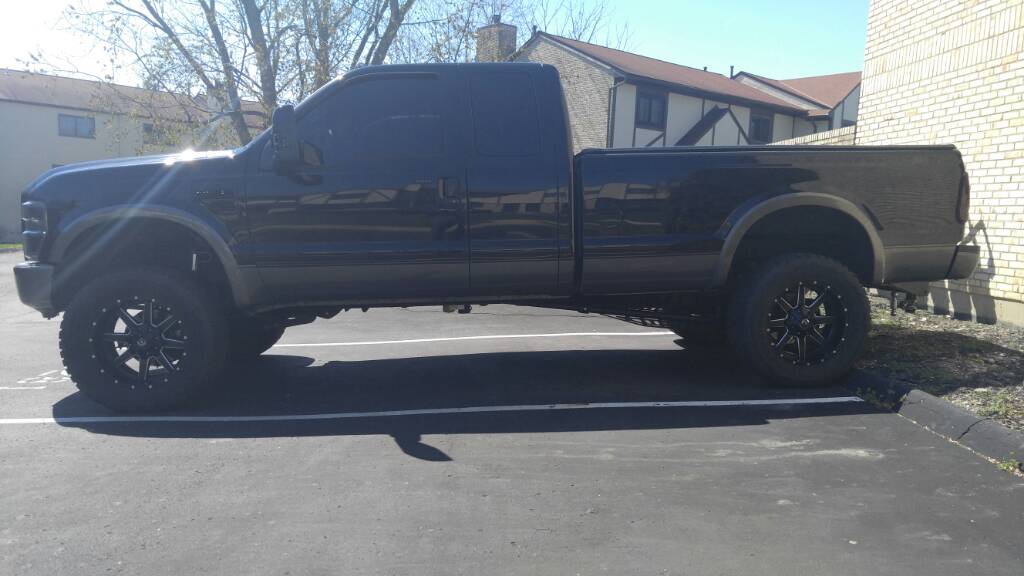

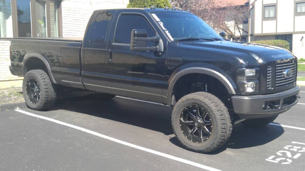

Anyways, this was the first full good weekend of weather and I was finally able to get my truck clean. Doesn't look half bad...

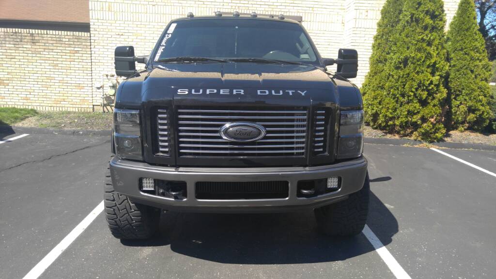

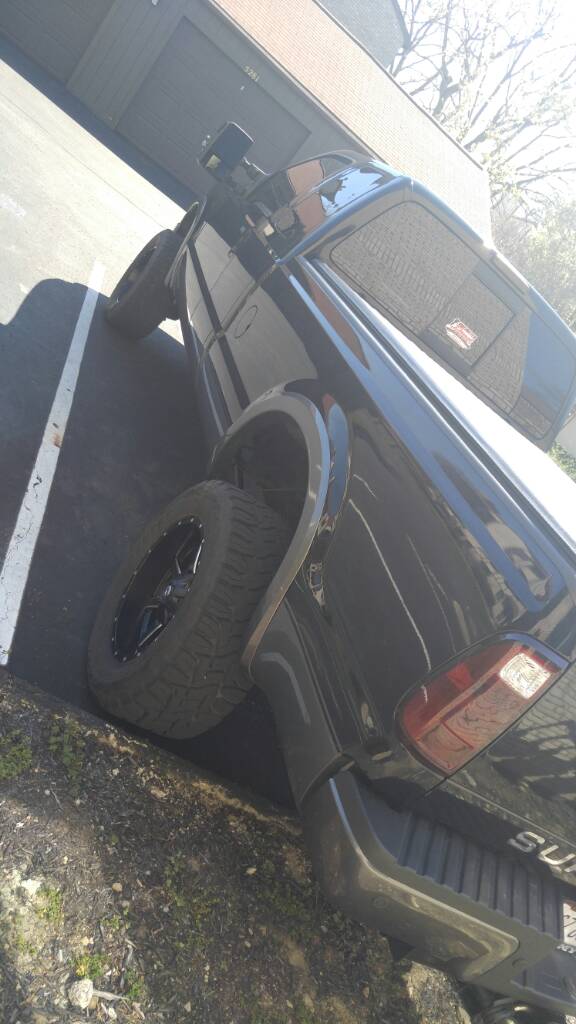

And some exterior shots of the truck itself cleaned up
Sent from my VS990 using Tapatalk

Great seeing the truck and meeting you.
I was fortunate enough to take the truck for a quick drive and I must say it is an incredible setup. It spools just as fast if not faster than I remember my stock turbo tune only 6.4 did, and the power is obviously nuts.
Really well built truck, now don't tinker with it for a while! Just enjoy it!

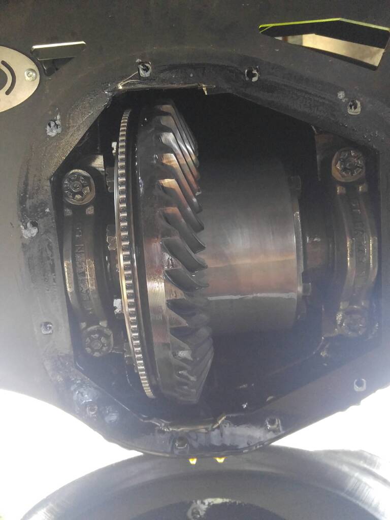

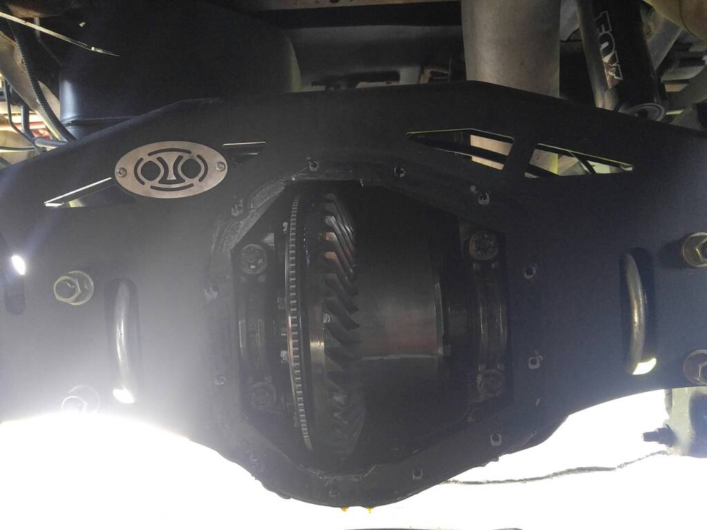

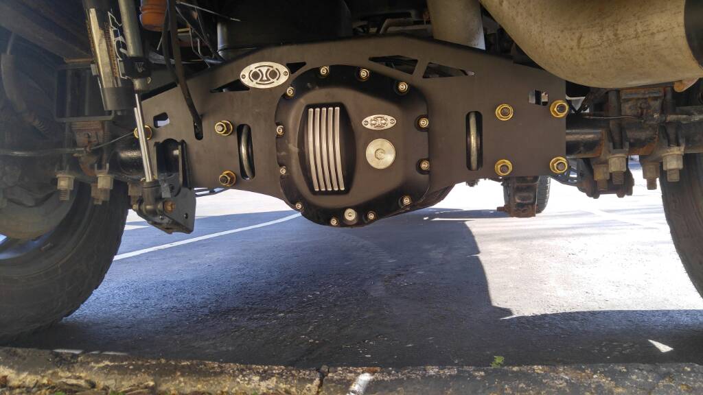

Changed out the Fluid today after 500 miles of having the truetrac in. Put in some Fresh Lubrication Engineers 704 85-140 Diff Oil courtesy of Jim K. Want to give a big thanks to him, this oil is legit. Between the True Trac and the LE oil this truck hooks up so hard in 2wd, it's unreal.

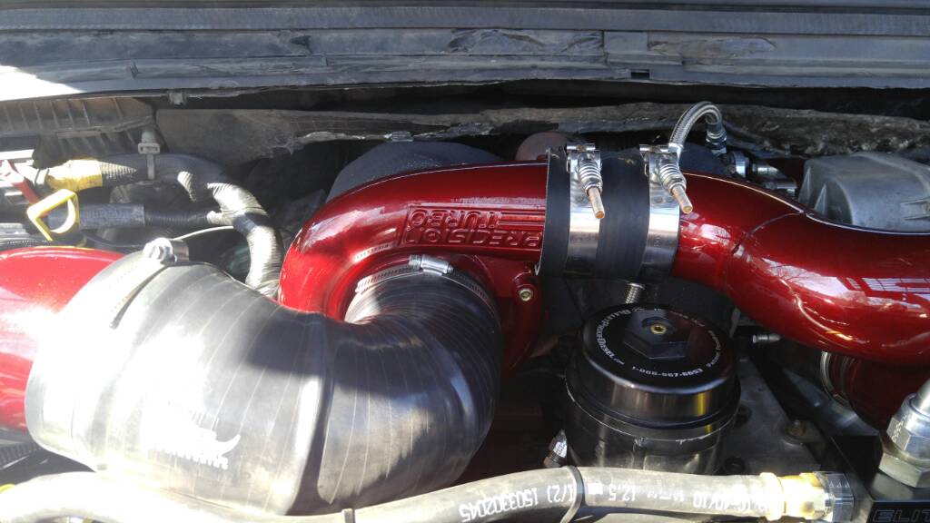

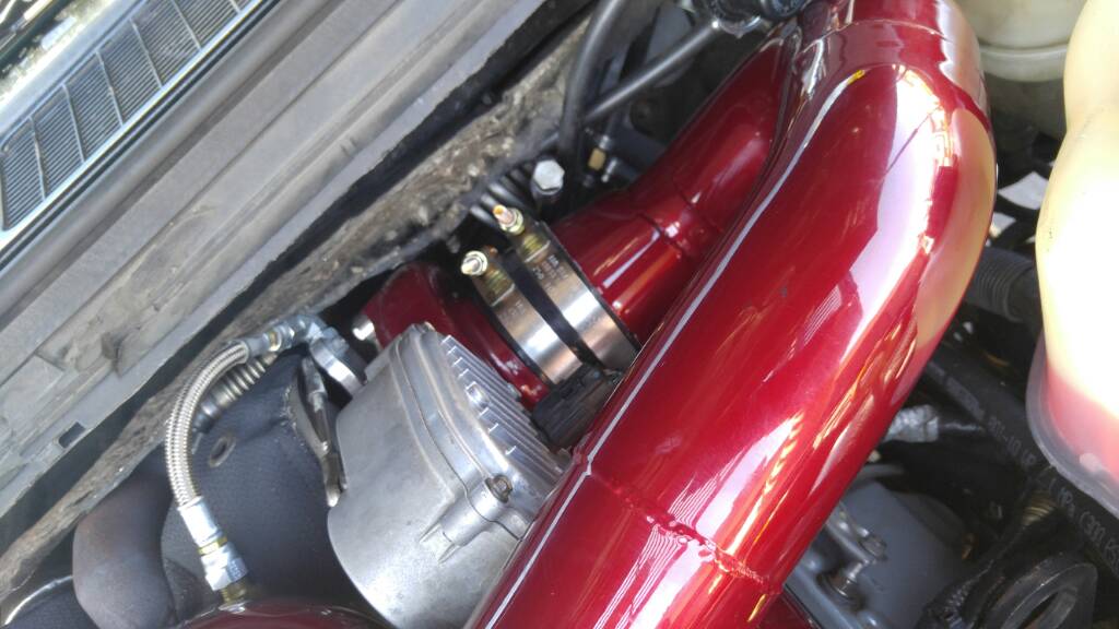

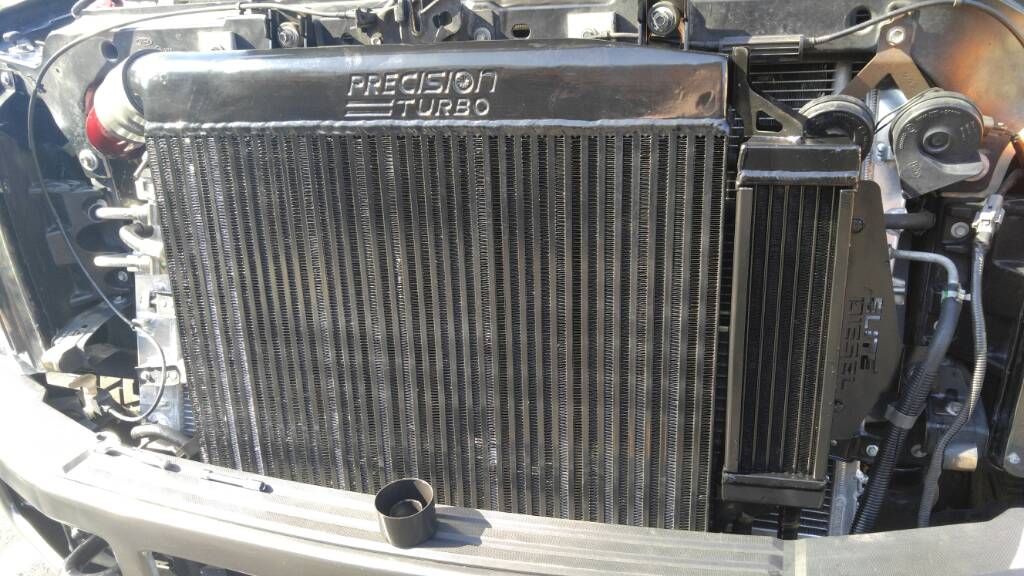

Well I haven't updated this thread for awhile as there was really no need to but changes are coming, just waiting on the industry to release the parts needed.

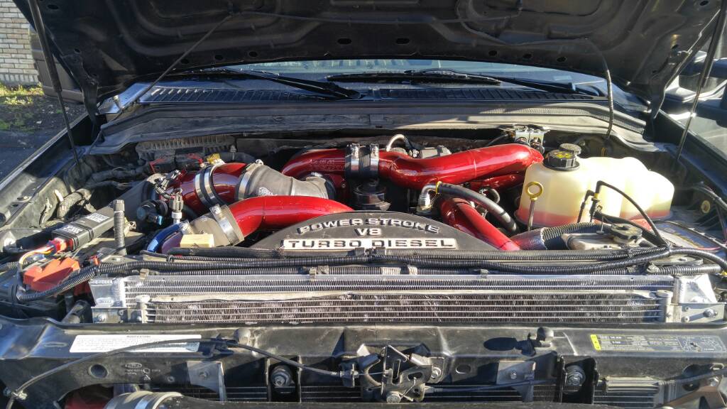

The truck has almost 20,000 miles on the new motor/trans setup, and about 8,000 of that is with the Gen 2 High Powers and Fuel System on there making 800+ whp. Absolutely flawless setup.
The Only changes that have been made were very minor, I added an aluminum coolant tank from No Limit Fab and I added an Edge 12V kit and EAS sensor kit to my CTS 2 to be able to run it independently and away from the OBD 2. Other than that the truck is the same as shown a page or two back.
