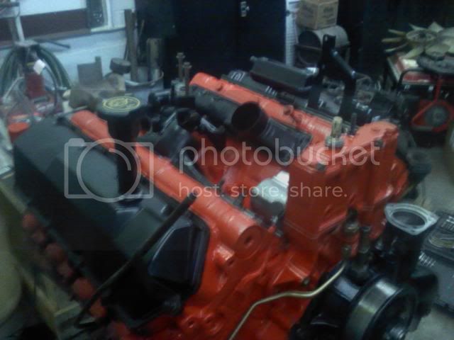

Another question. Whats the best way to clean/paint an assembled engine? Its not that greasy, and most of the factory paint is still on it.
Chvyrkr
2,204
Like Joe said, degreaser, then brake clean on the hard to scrub parts. After I did that I rinsed the block in water again, and hit everything with shop air. Then painted it the next day.
That worked out pretty good for me. If you see fisheye's on your first coat, stop painting and clean that area again.

You guys just using regular paint, or engine paint? Only thing i'm really missing at this point is paint. Can't decide what color i wanna do, as i haven't found a dark red/maroon engine paint that matches my Toreador red truck.
