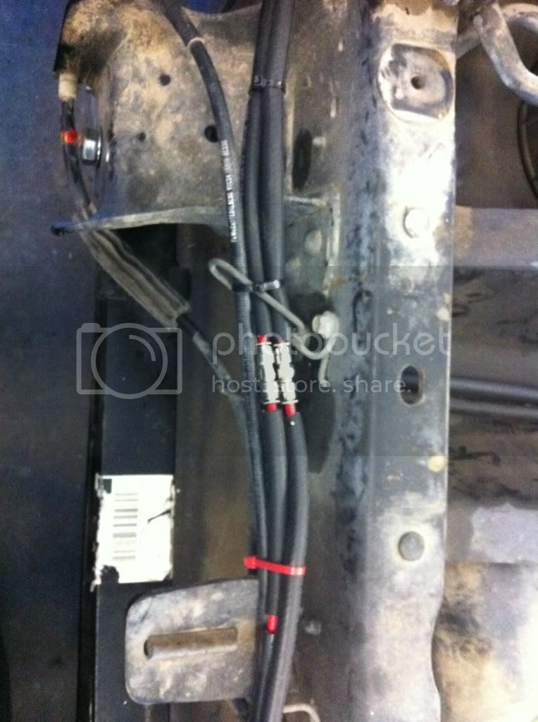

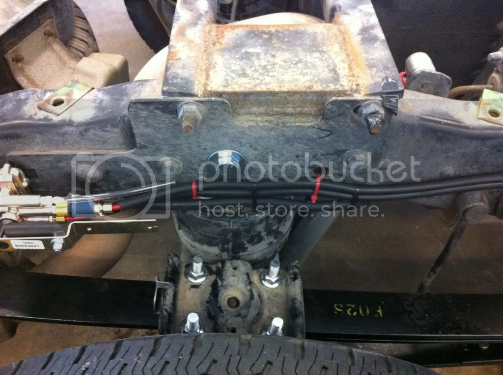

Out with the old. In with the new
G Racing
1,643
Southeast Texas

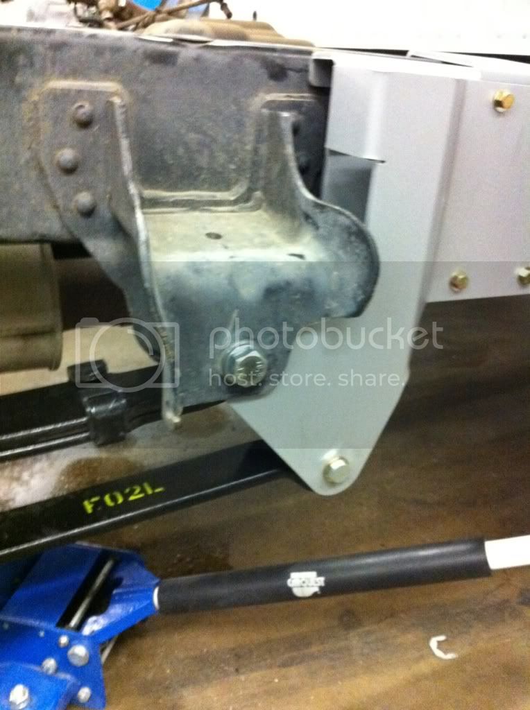

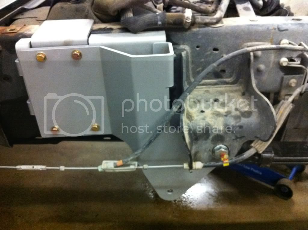

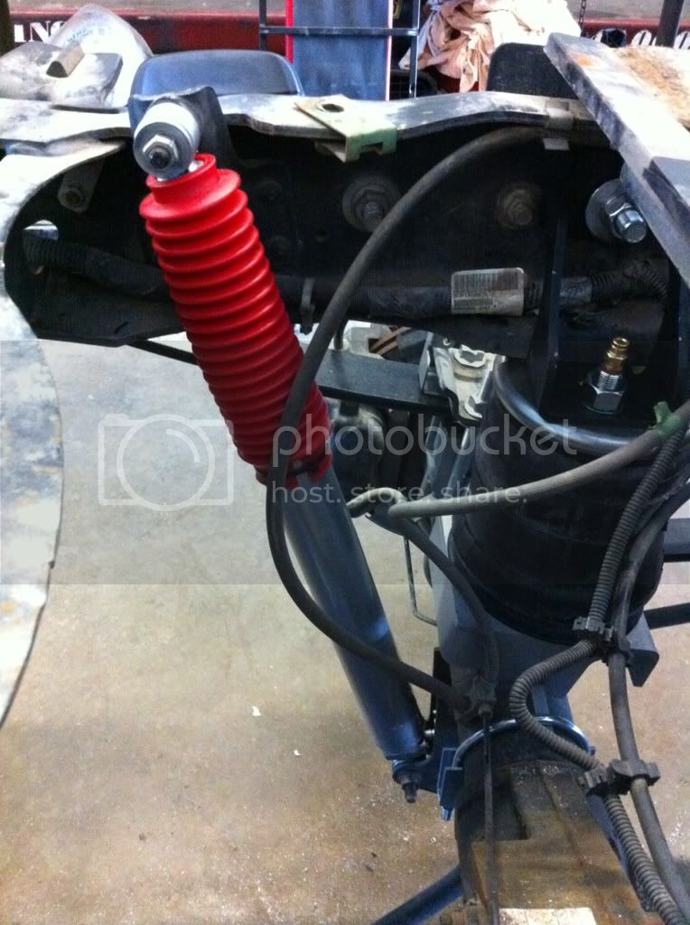

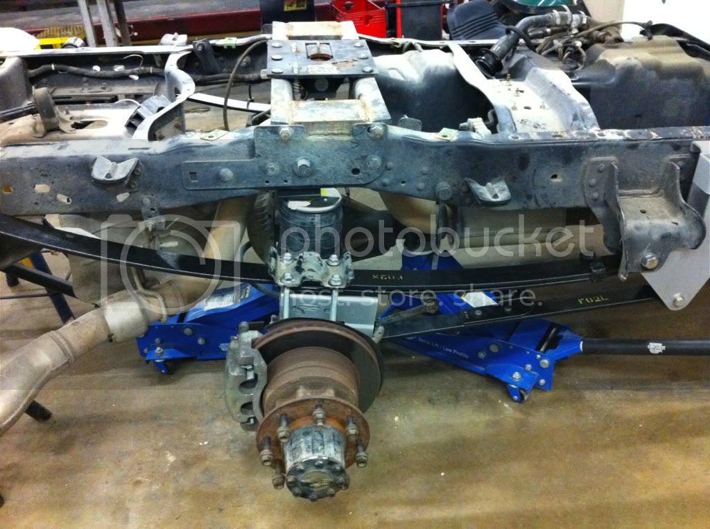

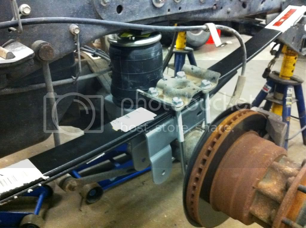

So there's only 1 leaf that is full length now? How was the ride after install

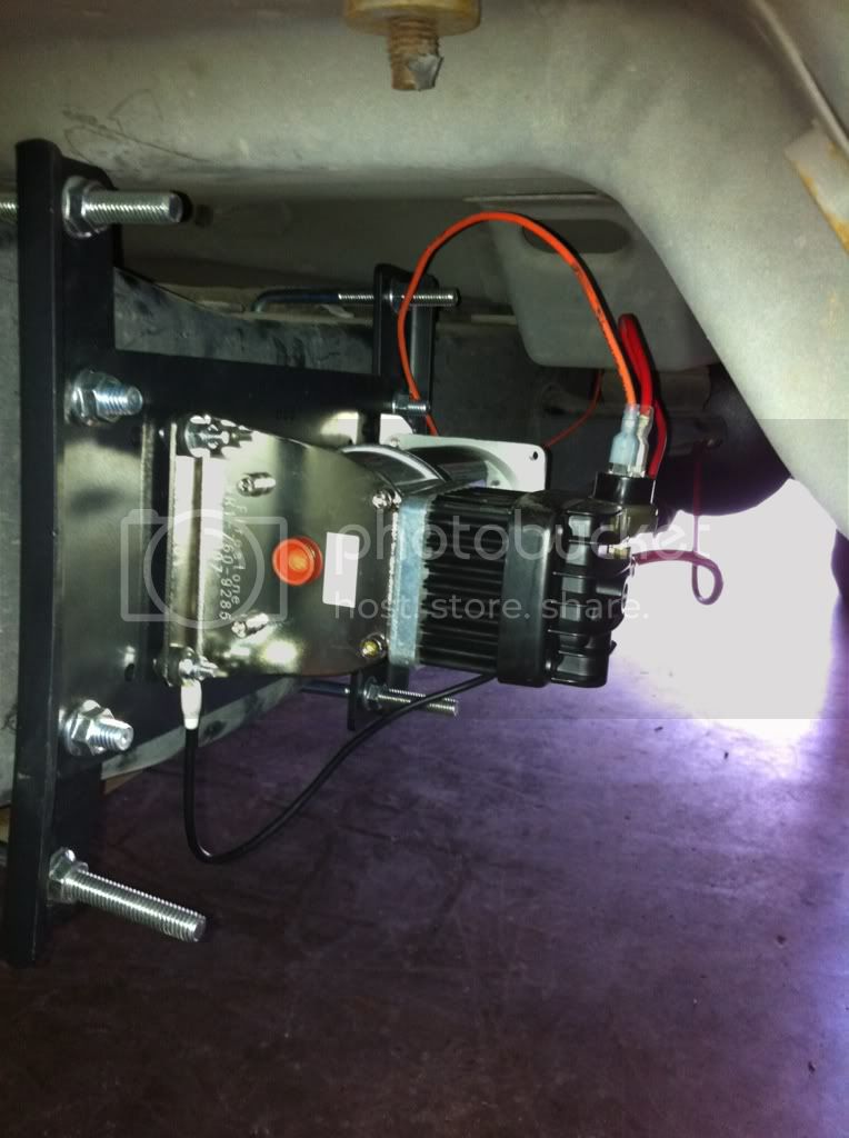

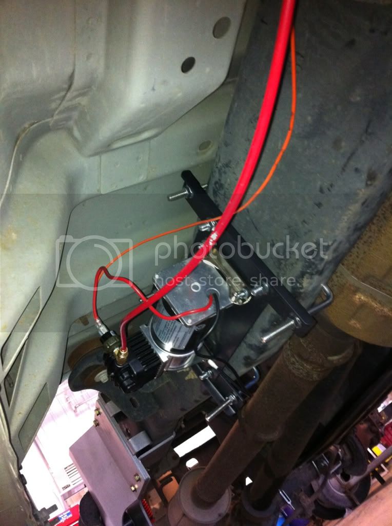

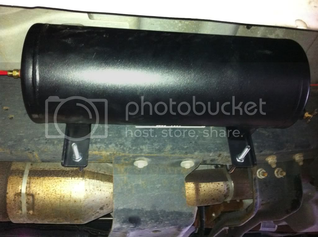

Yes one full length spring. Haven't had the chance to take it out for a drive yet. I decided to put 2 air pressure gauges in and I'm waiting on those to show up to complete the install.

interested to see how that turns out. seems odd to only have one but i like the install and how it works with the turnover ball

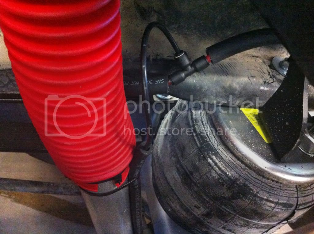

Made a few trips through town and the truck rides WAY better than stock. It rides almost like a half ton truck. You don't feel every crack and rock in the road lol. Next test will be with a loaded trailer to see how it rides.

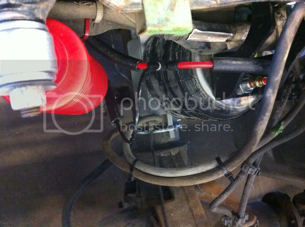

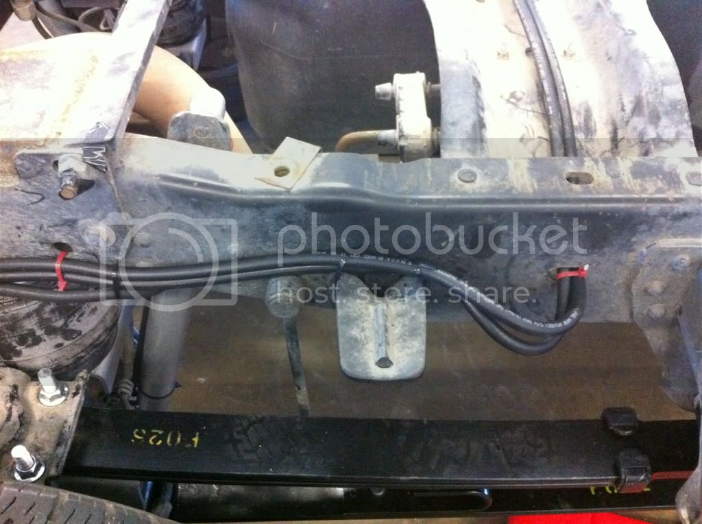

if you are able to put a camera, down there, check to see if trac bars are a mandatroy thing with just a single leaf.
it would seem that axel wrap would be a large problem. i see that its also a split leaf, one over, one under the block, which would help, to some extent i guess.
i had thought about getting one of those kits as well, as soon as paul started this thread, but i have been known to hook up to some......over weight things. which is what that would be good for.
but i have also been known to have a real heavy foot.

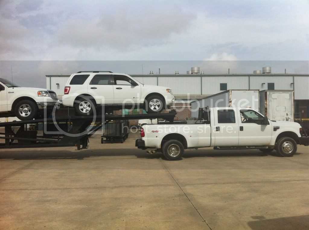

just cuz im curious, and if you have the camera capability, hook up to the trailer, loaded, make it level with your air, and apply the trailer brakes fully, then pull against it with the truck. and give it some serious juice. nothing long duration, dont want to hurt your trans or anything.
this will simulate hooking up to something.......heavy, and taking off. or out and about......playing. if your still game, TRY TO MAKE IT twist up. if your axel doesnt twist up, price me one of those kits.

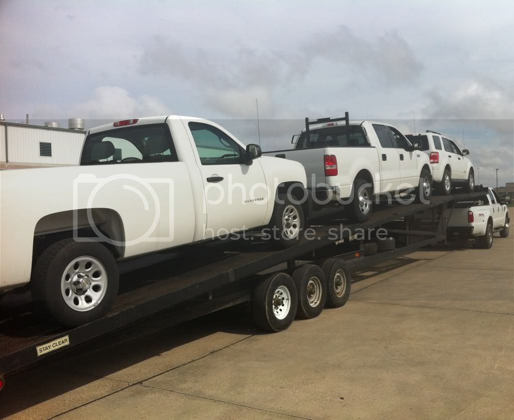

If you look at the fourth, fifth, and sixth photo I posted you will see what is called a j spring. It connects to the front bracket and then to the axle. It acts as a torsion bar to limit or prevent most of the axle wrap. I hooked up the take three and loaded three vehicles on it. The rear of the truck sat one inch lower than than empty with no trailer. Didn't take it out for a ride but next week I'm going to load the three trucks back up and go for a drive. Sorry but I don't have a video camera to hook up.
