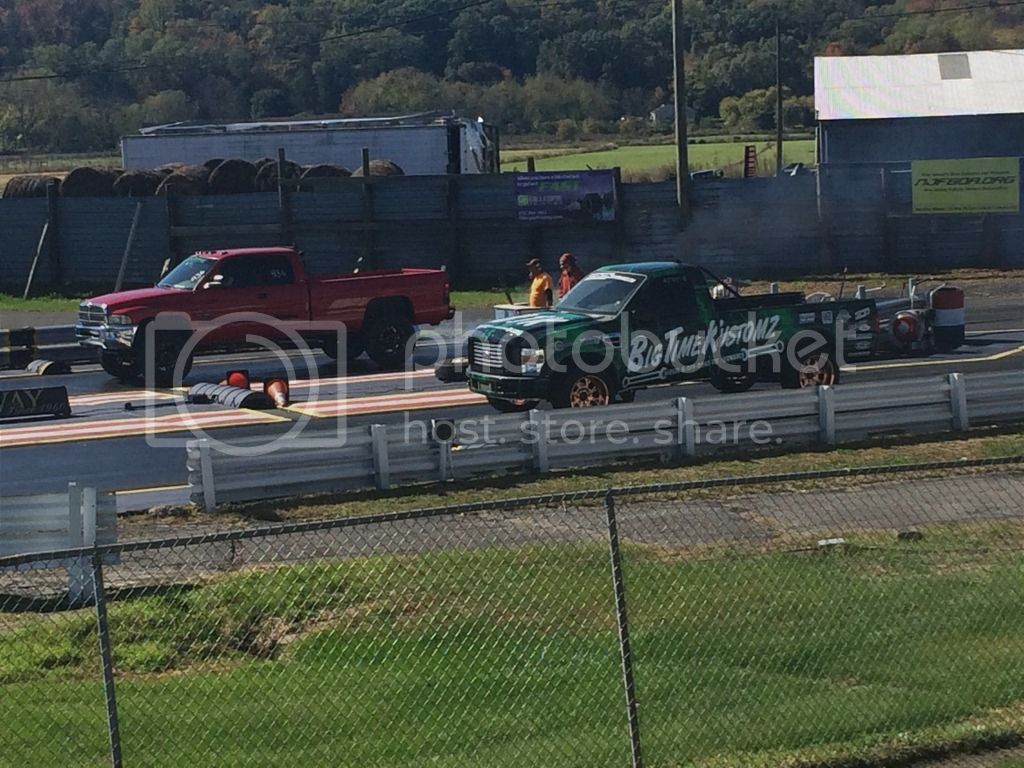

here was the time slip from Friday night, and a picture from Saturday. unfortunately Saturday I couldn't get the turbo to light on the first pass, then we found a broken rocker arm so we were done for the day but non the less, extremely happy with getting into the 10s Friday night on fuel, should be able to get a little more out of it on fuel before we start spraying it.
