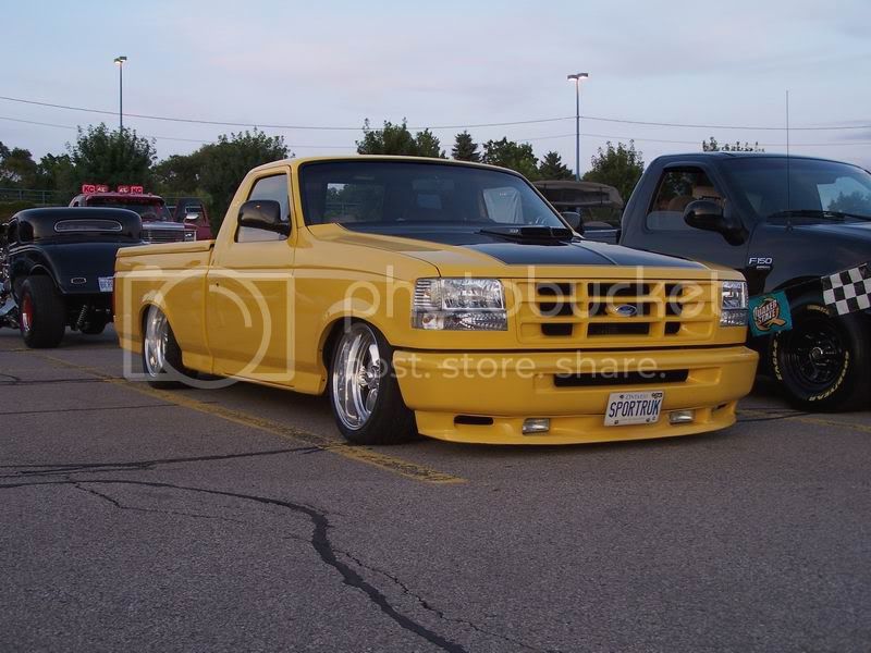

Saw pictures of a chop top f150 at work yesterday, bottom line, I will NOT be doing that....Waiting on my buddy to get here to do some more teardown

I watched an episode of West Coast Customs on Netflix where the did a slight chop on Jesse James' Chevy 1500. The way they did it, it wouldnt be too terrible. They kept the stock front glass, and just notched it at the base to lay it back a little. I think they ended up with a 3 inch chop, maybe more, and kept most of the factory glass and build the cab around it. They may have even kept the factory glass in the doors.

The way the back of the cab angles, I just don't see it coming out looking right. to make it look right would be such a subtle chop that it would not be worth the time and effort to do it.
