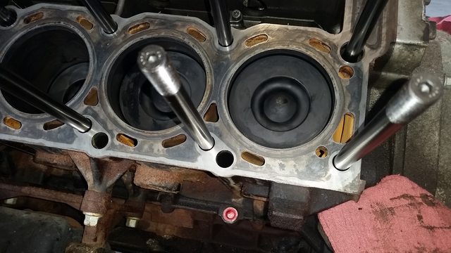

I like to see the stains all around evenly. I'm not sure if I see that on yours

Cleaned the block with plastic razor blades to get off all that I could, then used adhesive 360grit sand on a long piece of flat wood. And sanded them I'm an bottom left to top right and opposite motion.

That's definitely new to me... Not something I'd personally do.
Well all you can do is get the gaskets off and look for the failed area. examine that spot on both the heads and block.

Hmm that's crazy cause I was asking around about 1-2 months before I started the job and that was the most liked method I got in my build thread on here.

The block didn't look clean enough to me. JMO.
Were the heads taken to a machine shop?

Any cleaner than the one I posted and you have taken off metal.

When using the sand paper board method, I like to use a 2" x 2" square stock steel that has been ground on a surface grinder top and bottom. Then I will put some blue machinist dye on the block then sand and it will show you your high and low spots. The problem with the wood is it will flex.

I agree with Cobra. All of my Deck surfaces look cleaner than that and I've never had a 6 liter come back after new Gaskets.

I know when i do engines here at work i use a wire cup or a plastic finger roloc disk... Dont remove any material from the head or block but leaves everything clean... **** i work on has 40 head bolts for a 15l i6 though
