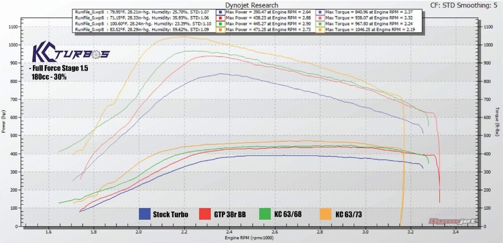

On the dyno when we tested the .84ar and 1.0ar back to back... the 1.0ar made 2-3psi less boost, 3-5psi less ebp, 10hp less, 50egts less and spooled noticeably slower.
For me... I would take the better power, quicker spool up, and 10 extra hp any day of the week. 5psi of ebp and 50egts won't make/break anything... but the quicker spool up is very noticeable.

My all time favorite so far is 63/73/.84... I think that is going to be our most popular turbo

Did you ever do a comparison between that and a 38r?
Sent from my Pixel 2 XL using Tapatalk
Yep... just need to find time to make a post about it, upload photos, and type up a write up. We did post something on facebook if you wanna check it out. We compared stock vs 38r vs 63/68 vs 63/73
https://www.facebook.com/KCTurbos/posts/2240014902876744
Not sure if I should continue posting all the bigger turbo testing here... or start a whole new thread.

Curious what you don't like about the .84ar... what exactly does it do that you don't like.
I'm an idiot. I remember now. Thanks!
