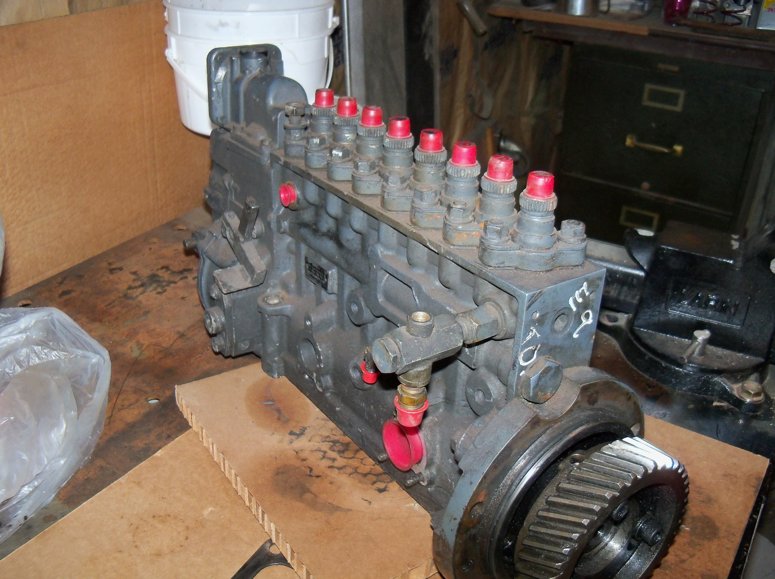

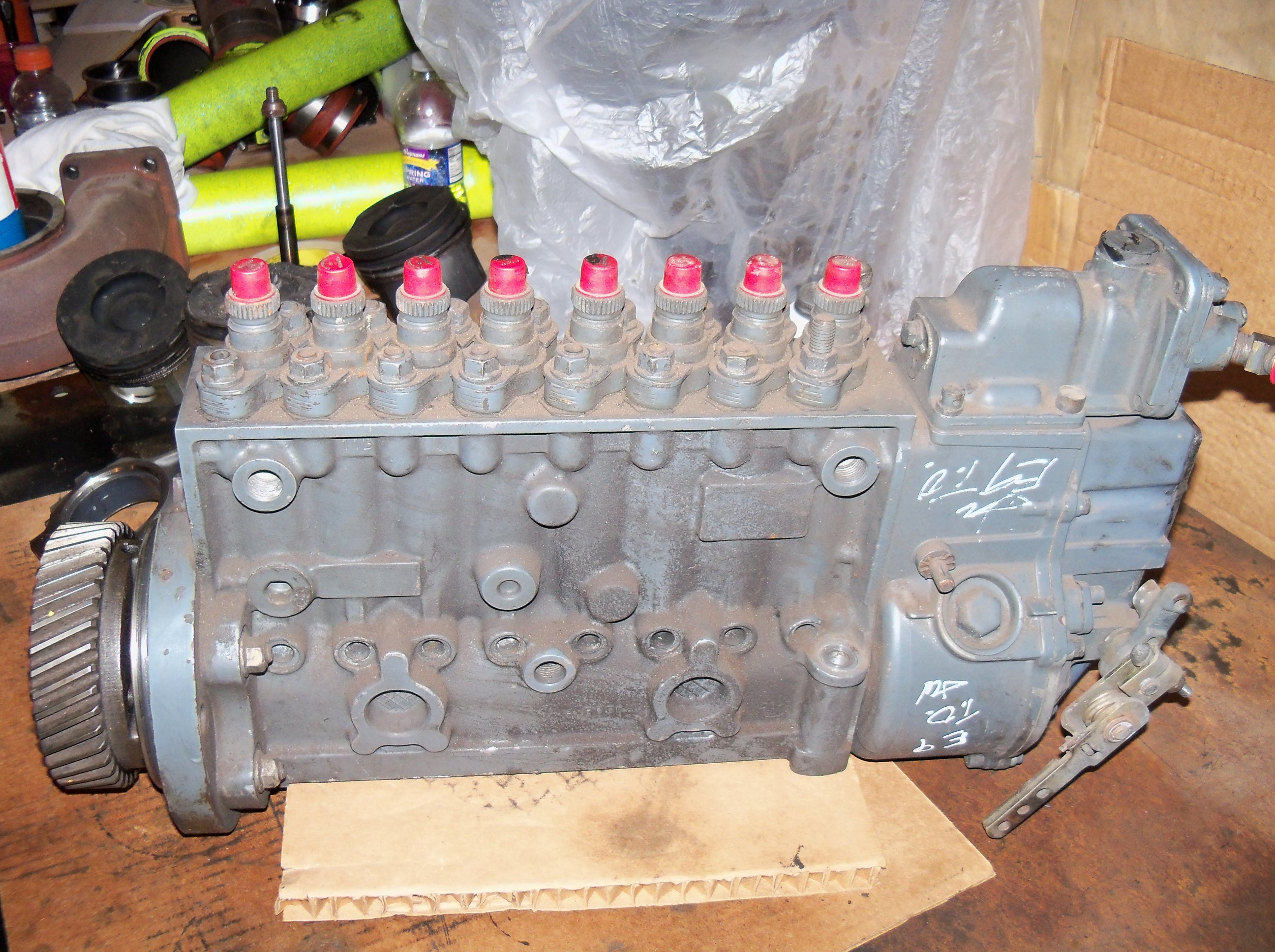

Here ya go Jason a couple pics of a stock 8 cylinder p7100.
That pump is off a Mack E9 998ci V8 motor. It was offered first with a V8 injection pump, then later offered with the Inline 8. I think the last year that engine was offered in North American Trucks was 1998.

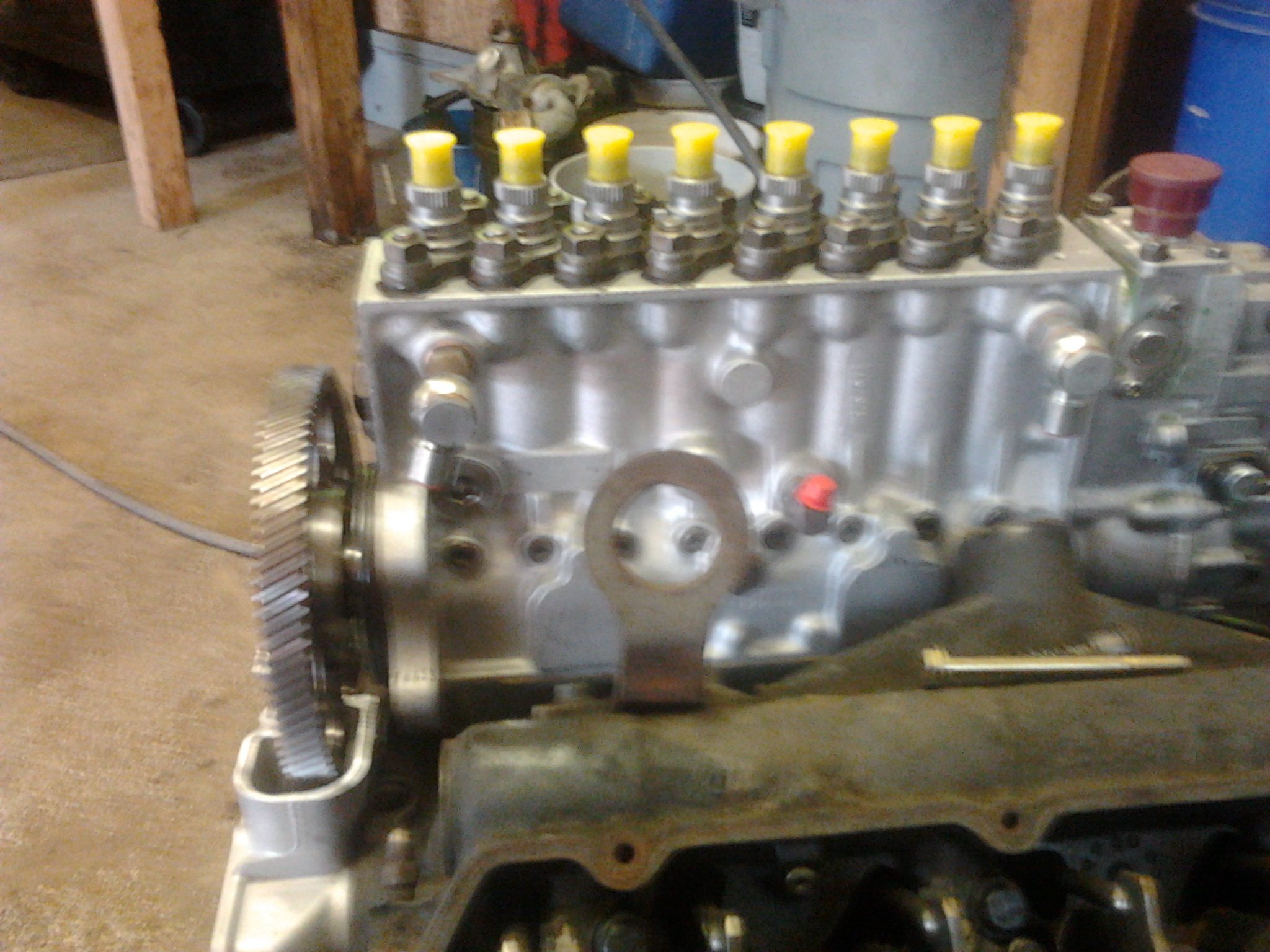

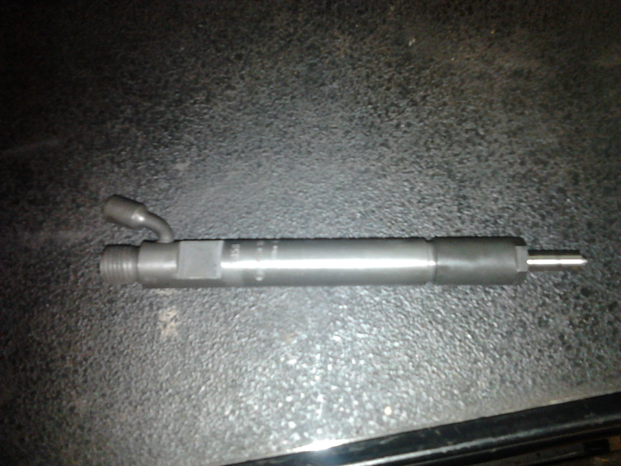

Here's some of my stuff.
IMG_20120623_124247.jpg 8.3 Cummins injectors
IMG_20120628_173325.jpg P3000 with Rsv/AG governor
